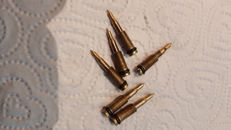

5 years 7 months agostrate6 wrote: On to the 6 x Primary Circuit Mixture Screws. I used a sheet of 2000 grit Wet & Dry Paper to carefully reduce the length of the end needles and re-profile them as Scotch recommends. This is probably the most inticate part of all the mods, so I used a good magnifying glass to ensure all was good. I think these will make a big difference to the whole set up of the primary circuit and make it much easier to work with. ]
Thanks Pete, I think I missed the mixture screw modification. Would you or Scotch please add a link below? Sounds like a really scary procedure though

Here you go.............courtesy of Scotch.
As Scotch has said, its something you need to do very carefully to gain the end result.
Very light grade wet and dry paper and a magnifying glass and do a little at a time and constantly check so not "over done"
www.kz1300.com/index.php/forum/carburato...le-performance#24910
