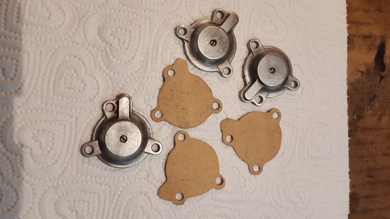

Next I made gaskets for each of the of the 3 Enricher Circuit Diaphram Covers and fitted them without the Diaphram and Spring.
