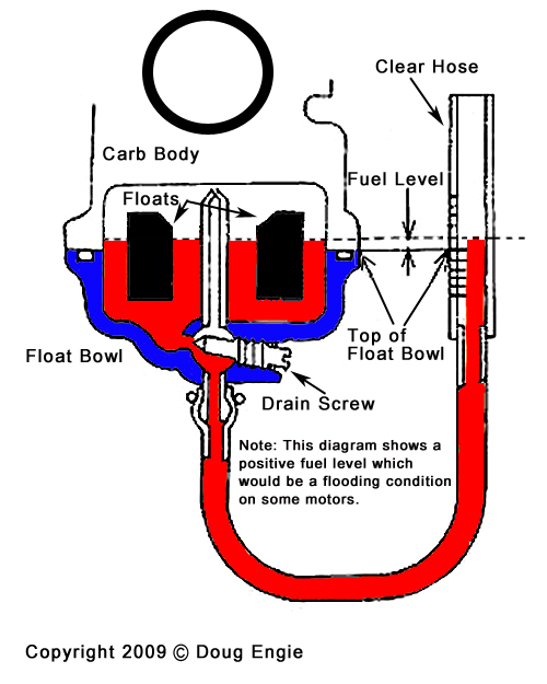

I agree with Craig about the float levels. What I've learned is that the black foam floats will get heavier if exposed to alcoholic fuel. (I KNOW that they get heavier, I SPECULATE that the problem is caused by the alcohol in the fuel.)
I was fighting sooty plugs till I set the fuel level by the wet method.
Good Luck!
Bill
Good Luck!
Bill

I believe the manual says 5.5 to 8.5 MM below the gasket.
Use the smallest diameter clear tubing you can find. If you see an air bubble in the tube up by the carb bowl the reading will not be accurate.
Bill
Bill

OK got that. Any idea where I get the adaptor for the bottom of the carb bowel, how do you know that both floats in each individual carb are shutting off at the same time
