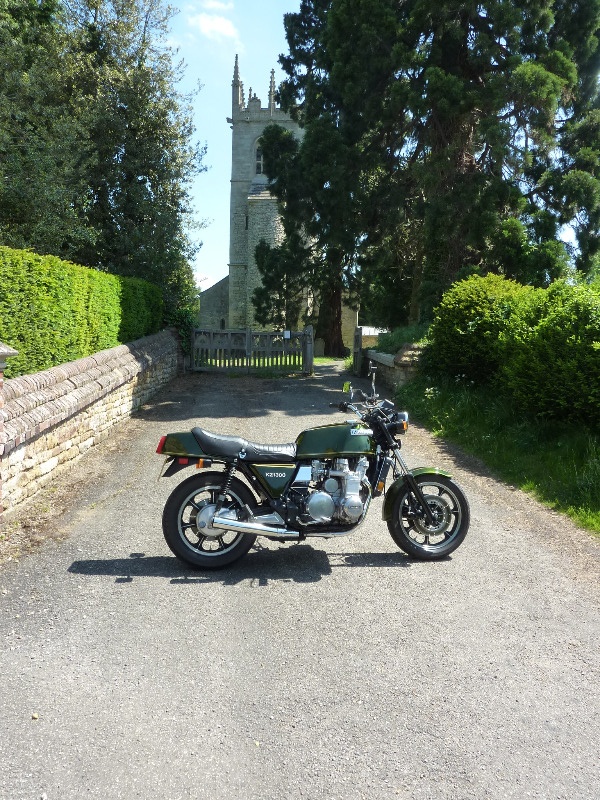

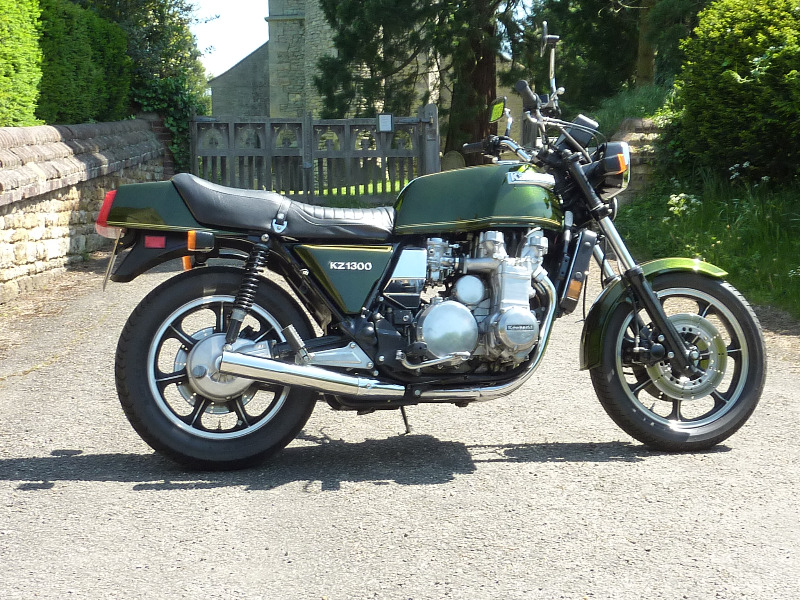

Last week with the promise of an impending heatwave I thought it best to finally get around to sorting my Z13 carbs, cognisant of all the helpful comments.
Could see absolutely nothing untowards to cause No.1 float valve to malfunction, thorough clean, double cherck and and reassemble and she is back on song - none the wiser as to what was causing fuel to overflow via the airbox breather.
Repeated start ups and 5 short journeys and she is again behaving herself: Today went for a bimble to hrough some of the local villages, ran absolutely perfectly: couple of pics of her sunning herself in the freak 27C temperatures.
Just hope she continues to "play nicely" throughout the summer
