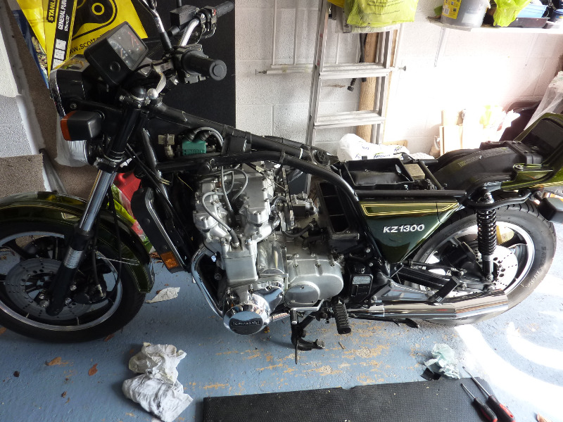

Well it did not take the old girl long: following a lot of work over the past year and a great deal of initial promise, she has again thrown a strop and wants nothing more than to laze around in my garage. All joking aside, its so frustrating that I just got her runnning perfectly after a couple of challenging years, and 200 miles later its yet another problem - in itself its no big issue, carbs off again and investigate why she dumpimg fuel out the airbox (I guess float sticking open) - but collectively it feels like "The death of a 1000 cuts".
I love riding my Z13, but am surprised how unreliable my Z13 appears in comparison to other old bikes I am fortunate enough to own - got me thinking if other owners had similar experience. Still, I can't see me selling her anytime soon :whistle:
