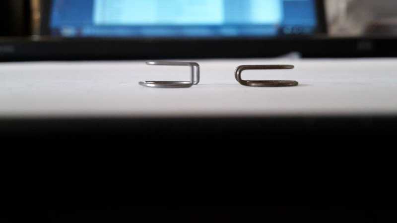

Herewith post Of mine from a while back that Scotch mentioned
I recently received more carb overhaul kits from Cruzinimage as I am about to rebuild 3 sets of carbs. Just awaiting delivery of the brass floats from Scotch who has been very helpful and prompt with his shipping of the floats.(Will be interesting to see how long they take to arrive in Zim - will keep you posted Scotch!)
Having said all that, I am going off this weekend on a rally and as my bike has had continuous problems with floading, I decided to check and clean up the ones on the bike. I had major problems trying to get the float levels sorted, the levels tended to be all over the place, when wanting to lower the level, I was suddenly floading and the same when I was raising the level.....bugger!!! After a few hours of cursing and swearing and wishing I had Scotch's floats in hand, I investigated deeper.....This is what I found...... Pic above!
The needle retaining clip from Cruzinimage is a different dimension height wise in comparison to the OEM clip, although very small, it was having an effect on my settings. Sometimes snagging and/or obstructing the float needle tang.
I changed the clips to the original OEM ones.....and waaaallllaaaaa!!!!! Within a short period all was sorted!!!
The clip on the left is from Cruzinimage and measures approx 3.3mm in height and the one on the right is OEM and ,measures approx 2.8mm in Height

Really glad to hear you sorted out the "Clip" issue. Makes you wonder how difficult it is for someone to recreate a simple spring clip to a spec.? I ended up making my own from a suitably sized tension-spring and a pair of needle-nose pliers. The first couple weren't pretty but got the third, fourth and fifth attempt satisfactory for the three required. A whole season of riding last year without issue ! Sometimes you have to spring into action on your own !
