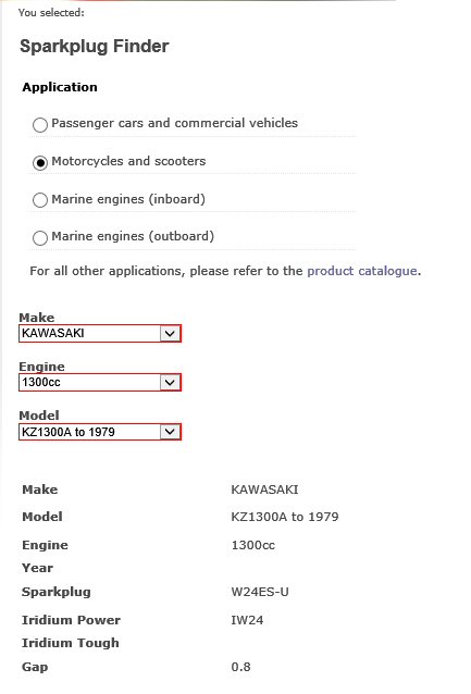

, I have Iridium plugs (BPR6IEX) in the bike at present, they've been in there for quiet a while now, I took them out the other day and cleaned the build up on them as a set of carbs I had on it were running rich for a while, I changed carbs and fuel economy is better ... blah blah blah .... anyway I was thinking of putting new "normal" plugs in, so I had a look at some NGK BPR6ES (pretty sure it has the screw cap???) which i'm pretty sure are the plugs to suit the 13, please correct me if i'm wrong, then I thought about putting Denso plugs in it instead of the NGK, went to the Denso site and put in the make and model of the bike and it gave me a Denso plug W24ES-U (this has a heat rating of 8 in NGK), can someone please do a list of plugs suitable for a 13 in different makes of plugs ??, or is it ok to use the recommended Denso ones or the ones they say are the same as the NGK plugs ???, Please someone let me know and maybe others who are as confused as I am , thanks in advance ... Pete.

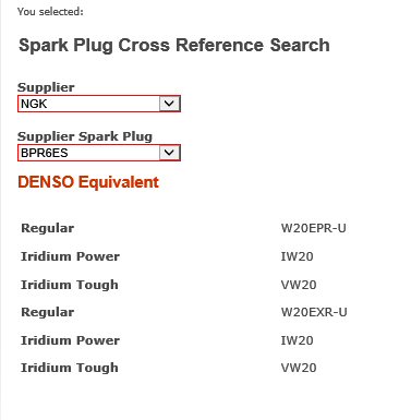

The Denso equivalent to a BPR6ES is a W20EXR-U from what I can find. It would take a lot of talking to get me to change from NGK.

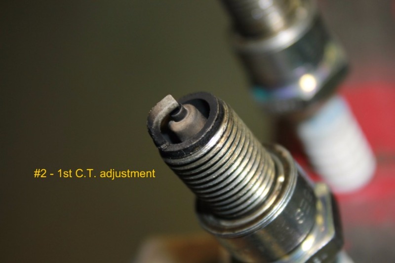

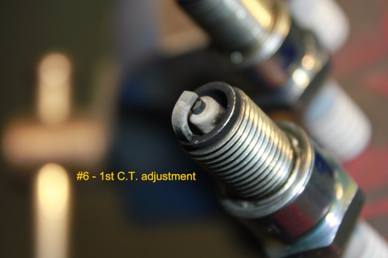

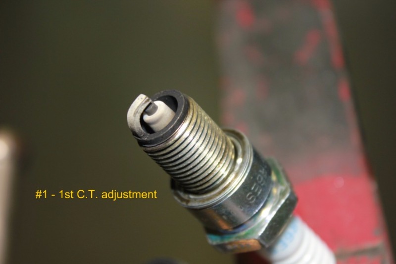

For 36 yrs I've set the idle by ear. An arbitrary 3.5 turns and then some minor tweaks to get the idle sounding it's smoothest. The color on the (NGK BPR6ES) plugs was always in the "Tan" range. Then broke down ( cuz the price was too good to ignore) and bought a Gunsons Color Tune, recently - just for "Shits & Giggles" Photos are after a first and second C. T. adjustment and "Chop". Need some tweaking I think !
