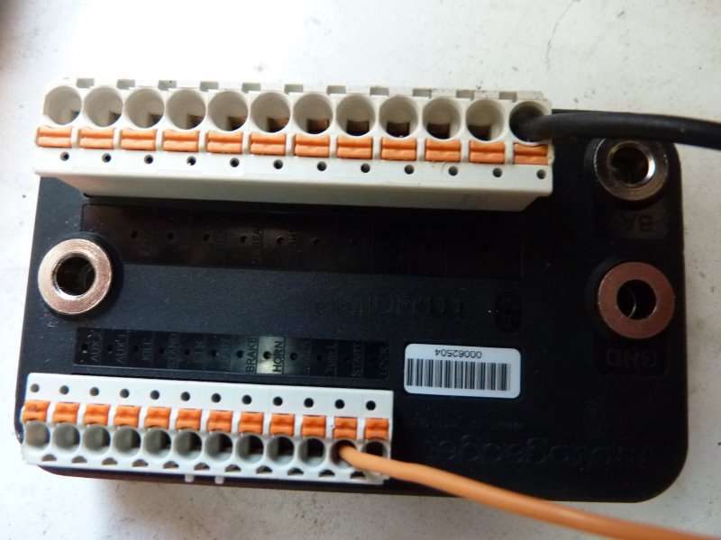

The second photo is the unit ( with two wires I attached ). As you can see or not see, the individual circuits are named , but they are almost impossible to read. The lettering is cast into the black plastic . Not so good. All the ads for this unit , including the box lid are photoshopped big time. But there are remedies.

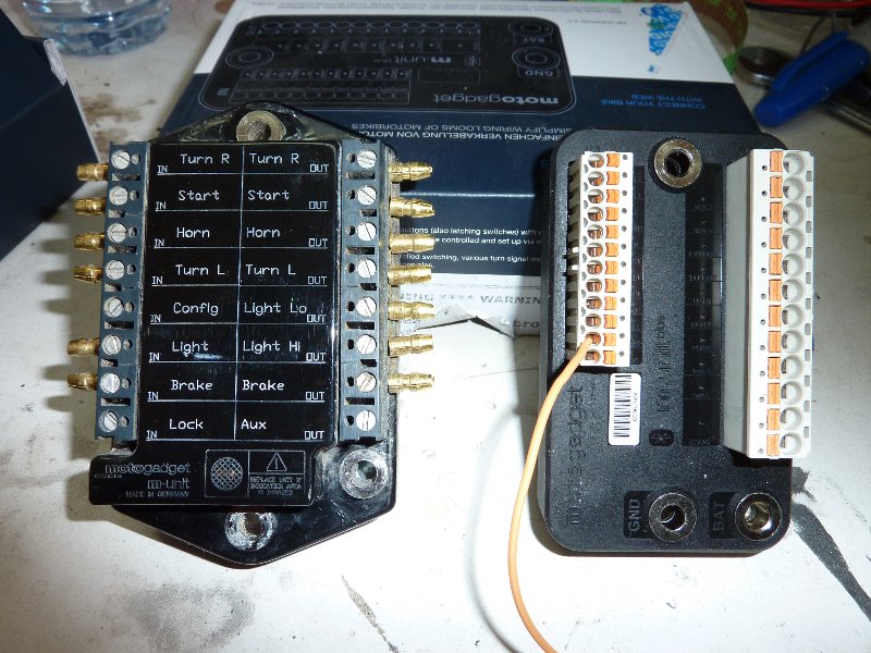

The third photo is of the original and the new. The lettering on the old unit I highlighted with a welders white ink marker.

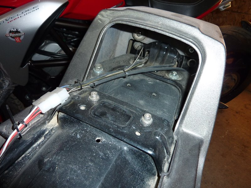

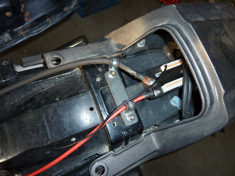

So the first thing was to find a location. The units preferred position is lying flat. It has some kind of gyro ? that measures is orientation so for instance, once the alarm is set ,and then the bike is moved off the side stand , the alarm goes off. To make that work, the unit would be wired into the horn.
So the most room and ease of access is in the tail section. But it required running a lot more wire. It's a long way to the handle bars
