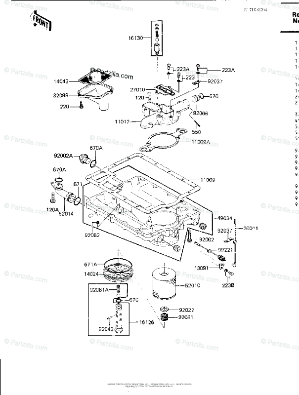

So as this build comes to an end I have one last electrical gremlin. Getting the oil pressure/level system to work with the aftermarket gauge cluster I'm using.
The oil light wouldn't go away after the bike was started, but I'm reasonably confident that the issue is the sensor not the oil pump.
A) where is a good place to put a pressure gauge to check the oil pressure?
where is the pressure switch? From what I understand from studying the parts breakdown,
27010-1038 is the level switch that is inside the oil pan. It attaches to 59221-1002. Is that the pressure switch or is that just a conduit for the level signal to exit the case?
Thanks
Isaac
Thanks
Isaac

If I'm not mistaken - and I very often am - I don't think the ZN1300 has a oil pressure sender - there is only an oil level switch.

Yeah it does. 27010-1038
Thanks to www.partzilla.com for the drawing and info
Specifically www.partzilla.com/catalog/kawasaki/motor...4/oil-pan-oil-filter

I'm confused: Fiche lists 27010-1038 as " SWITCH,OIL LEVEL" - is that supposed to be 'pressure level' or 'oil level'. If it's Oil pressure then I can't find a level switch. To confuse things, the ZN1300 wiring diagram show only an oil level switch:
..while the 82 KZ1300 has this extra piece, 25025-1003 (in addition to 27010-1038), listed as a "WARNER,OIL LEVEL" and which is not shown on the ZN1300 fiche. I can't find an A4 wiring diagram so not sure what it connects to.
Maybe 27010-1038 is both a level switch and a pressure switch? Or maybe it's the pressure switch and the ZN1300 doesn't have a level switch - seems weird that the KZ would have one but the ZN wouldn't.
