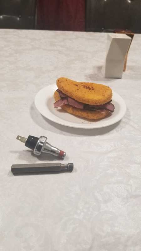

6 years 7 months ago #25188
by Rage10
Replied by Rage10 on topic Oil pressure/level switch. 85 zn1300
I said the cursing helps get stuck shit out. And it did! Got the plug out!
T40 didnt work. Drilled out to 19/32 for the next size up, spiral screw extractor.
That stripped , but tapping in a T45 did the trick. Only issue now is my 8$ Amazon pressure switch doesnt fit.
Wife seems to have put away my calipers somewhere so I can't measure and see what's wrong.
Tried puting in a 1/8 plug I had laying around and that doesn't fit either. So I'm gonna assume the hole is undersized for some reason. Whatever. Figure it out later...
Pic included for reference. Ran outta bread for victory sandwich so i used some chicken nuggets.

Welp, just put a tapered die on the pressure switch I had to make it fit in the tapered port. Got to finish the oil change then test it.
