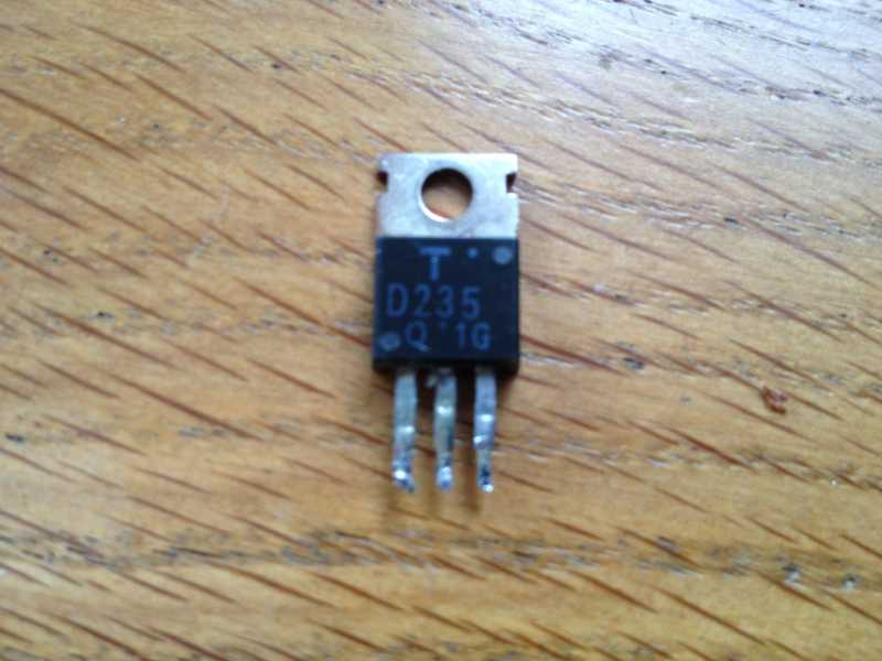

Got it all to bits and this seems to be the culprit
the number is D2350 .1G
all the other components appear to be working and the board is clean
the Zenner hasnt blown so there hasnt been a short.
cant find any info on the transistor, who made it and its values.
might go and see spotty birk at Maplins.
the closest match i can find is an NTE2317 but not sure.
Ian

- strate6
- Posts: 1085
- Thanks: 347
Re: Voltage gauge regulator
12 years 2 months ago
LOL !!!
Seriously...............look at EBAY number 110943146562
Pete F
Pete F
- kwak1261
- Posts: 417
- Thanks: 63
Sorted, order placed. good find Pete.

- Toddh
- Posts: 440
- Thanks: 62
This number also crosses to
d235 crosses to nte#152 price is $2.49ea My local supplier has 1 in stock price is $2.49
NTE152 (NPN)
Silicon Complementary Transistors
Audio Power Amplifier, Switch
T.
NTE152 (NPN)
T.
