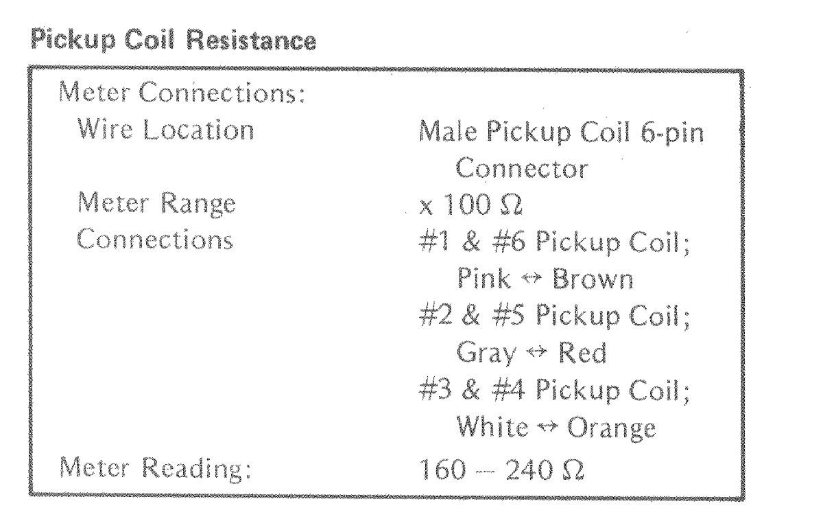

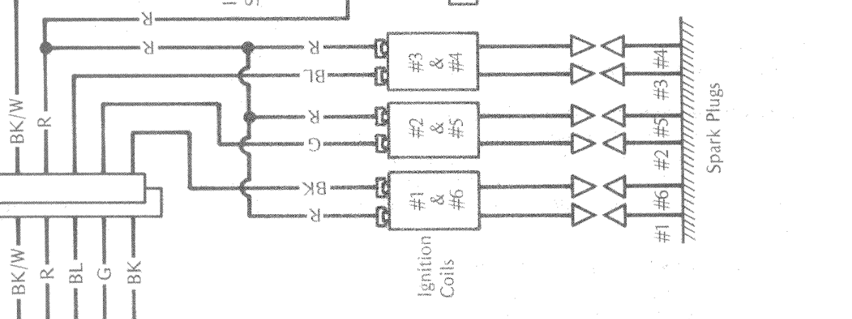

Tuomas,
I sent you on a bit of a goose chase this morning. You're working on a ZN1300 not a kz1300.
so, regarding the wiring-
pickup coil wiring as per the ZN Voyager manual-
Ignition coil primary wiring as per the wiring diagram from the ZN Voyoager manual

7 years 7 months ago - 7 years 7 months agoKawboy wrote: Tuomas,
The ZN wiring diagram I have shows Blue/Green/Black as per your earlier comment (I added the plug numbers): ??
