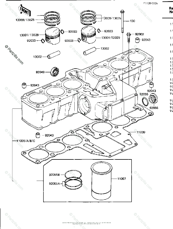

Another question. What does that bolt under the cover, in the middle of the picture, do? Feels like some sort of ratchet.
Is it some sort of tensioner? It is opposite to water pump.
Sorry about accordion playing at the backround. Not my choice.
That cover is referred to as a release plug item # 92066 (picture from Partzilla parts manual) and it gives access to the water pump drive shaft. On the kz1300 in order to remove that bolt on the end of the shaft, you have to have the cylinder head off. Why they put a plug access hole on the right side of the cylinder block to gain access I don't know. In order to remove that bolt you have to have a wrench on the water pump shaft to counteract the torque as you remove that bolt.

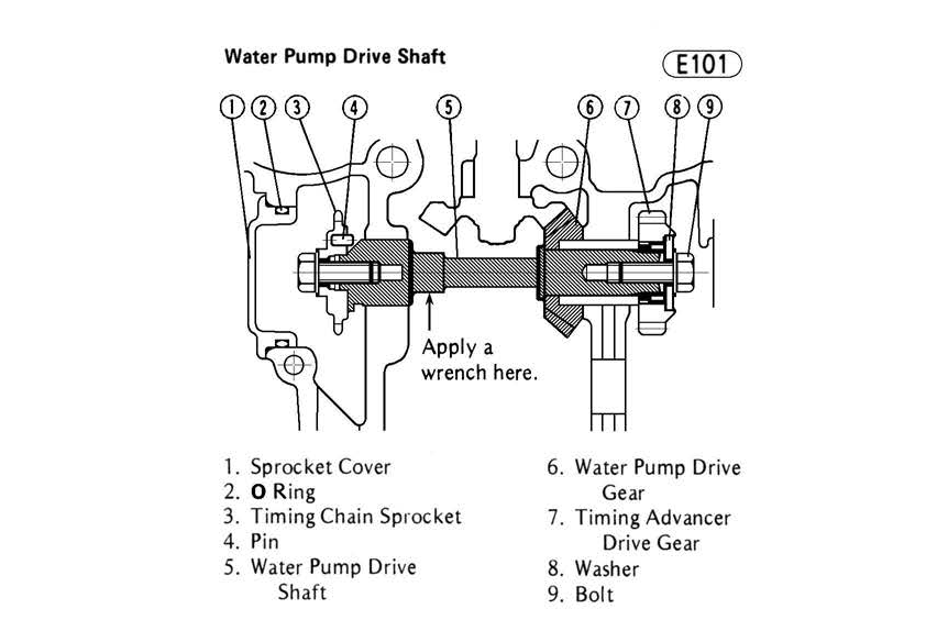

This is a pic of the kz1300 water pump drive shaft looking from the top. All the same parts except for the gear to drive the timing advancer which in your ZN is on the end of the crankshaft right side.
If you tried to turn that bolt and got a "ratcheting effect" Then you turned the water pump drive shaft and the racheting effect was the drive chain jumping teeth which means the drive chain tensioner is not taking up the slack. Not good.
