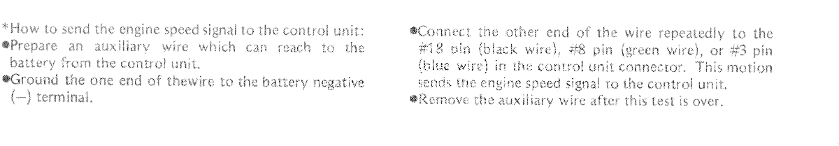

This is an excerpt from page 3-10 of the zn1300 manual. So the DFI Control Unit picks up a ground signal on pins #18 , #8 and #3
