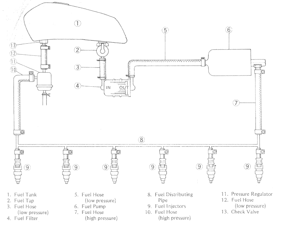

Finally met the guy after few weeks and we measured the fuel pressure and tried to find out if ignition advance thing (it says "Boost sensor" on it) works.
First the fuel pressure. We had industrial fluid dampened gauge and we measured EIGHT bars of pressure at fuel rail (well that seems enough at least..) and THREE bars after that fuel presssure regulator. And it holds at eight bars so no injector leaks or return flow via fuel pump. Feels like kinda high....it is not original fuel pump but it has been there for years, working flawlessly. These results we got with ignition ON and bike was not running as it still does not want to.

Looking at the diagram= The fuel pump supplies fuel to the rail and the injectors. At the end of the rail is the pressure regulator. The regulator drops the supplied pressure the pump could obtain, down to the required 2.27 bar (33 psi) at idle and 2.47 bar (36psi) at just off idle. On the downstream side of the regulator is the return line to tank and it should be slightly measurable but basically atmosphere.
So if the pressure gauge is on hose #10. it should read 2.27 - 2.47 bar depending. On hose #12 basically nothing. If the injectors are pressurized at 8 bars the likelyhood of them closing after the signal pulse from the DFI would be nil. The spring in the injector is at a spring loading to close the injector under normal pressures. If it was too strong a pressure, the signal pulse that opens the injector by pulling the plunger via an electromagnet would not be strong enough to open the injector.
Then there's item #13 a check valve at the tank fitting? Somewhat unusual since the pressure regulator is in fact a check valve by nature. you might also want to pull that check valve and see if it's blocked or stuck. No way should there be 3 bar on hose #12. If the check valve is spring loaded maybe a couple of psi could be measured (0 .27 bar maybe?)
Sounds to me that your regulator is stuck partially closed.

I agree, you shouldn't see any more than 2.5 bar downstream of the fuel pump.
