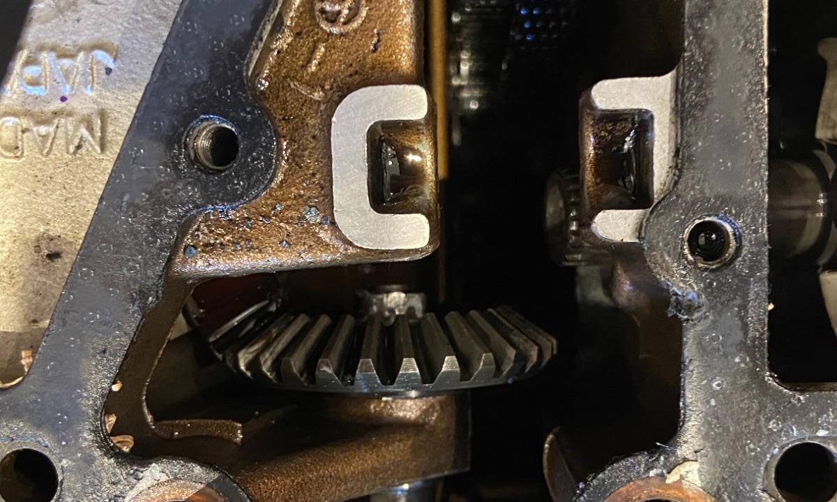

So you can't get a 6 point box end wrench on that nut with the water pump drive shaft out?? Those 2 shafts , water pump drive shaft and the water pump shaft should be on the same plane, so I'm struggling to see how a box end wrench won't go on, now that the drive shaft isn't in the way.

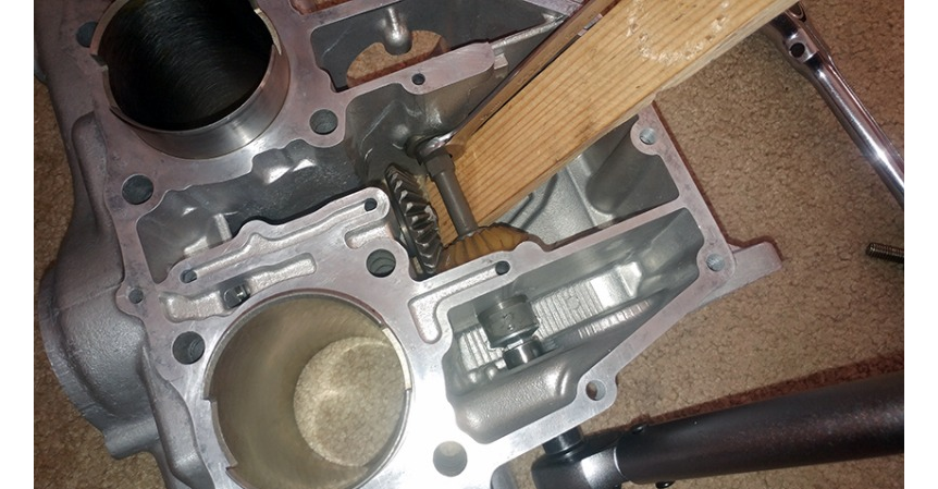

A picture of the access for the water pump shaft from the bottom side of the cylinder block. Just for reference.

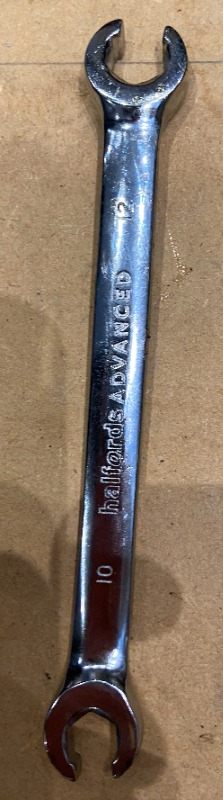

unfortunately I only have two 12 point (ring) and open end combination spanners. I don't think I have ever seen 6 point ring spanners but if I don't get it removed once the block is off I will take the block to my trusted professional bike shop.

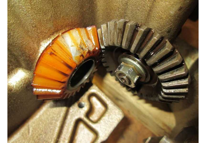

I do have a spare nylon bevel gear if it comes to the point where heat has to be used but not 100% sure it was for A1/2 engine with pickups behind block - I reckon I'm about 95% certain as it has the extra cog to drive the timing pickup shaft

I still struggle to see how the access is limited with that shaft out of the way.

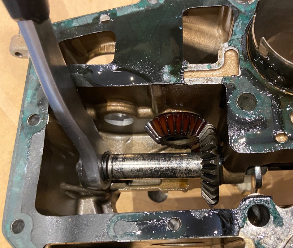

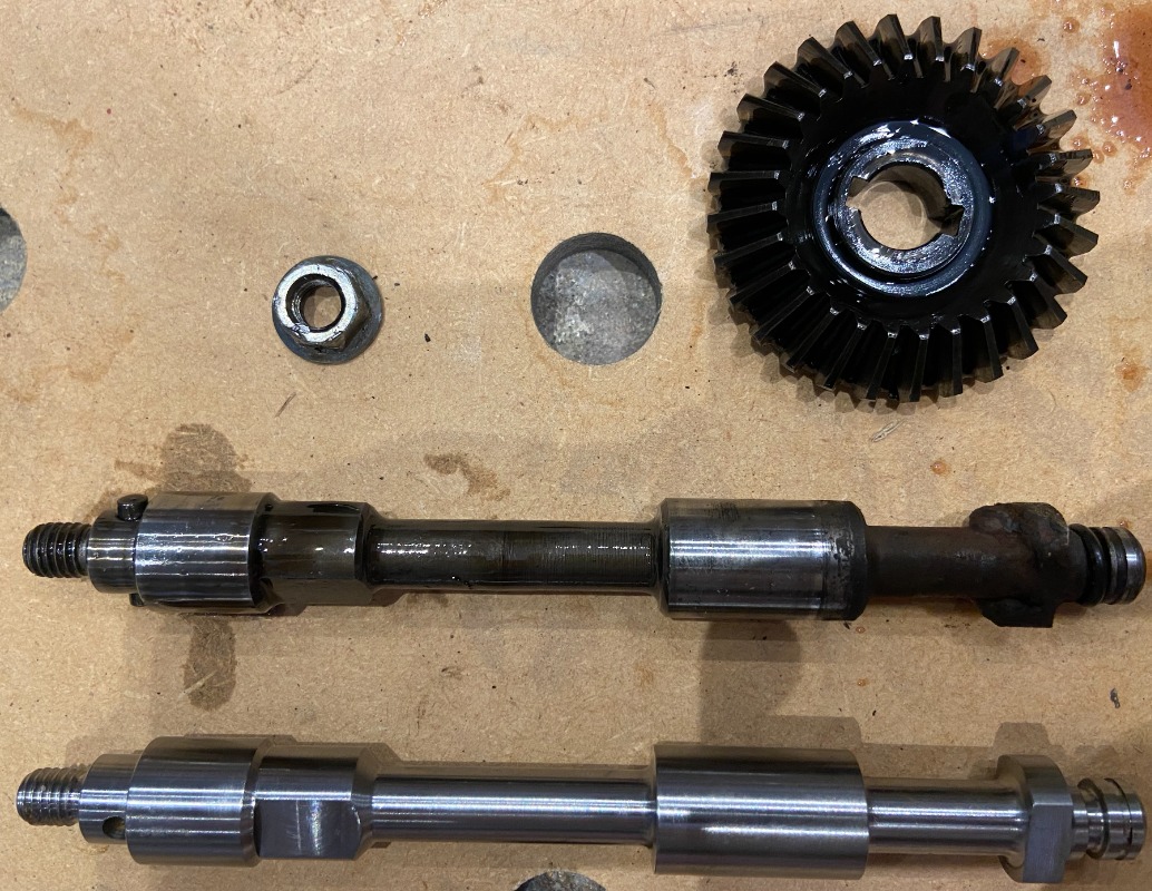

I treated myself to a new open flare spanner but that did not help. There just isn't good access to the nut from above. I took the block off and found that a 6 sided long reach 3/8" socket is a near perfect fit between the nut and the rear of the cam chain chamber., It's all out now and a new flanged nut has been ordered

Glad to hear that you managed to resolve the issue. Obviously, the pics I was referring to are from a different engine casing and I now can see your dilemma. Tight spot for sure. Kudos !! Hope it's all down hill from here. if nothing else, it was a good opportunity to talk about the advantages of the 6 point drives. Thanks for that.
