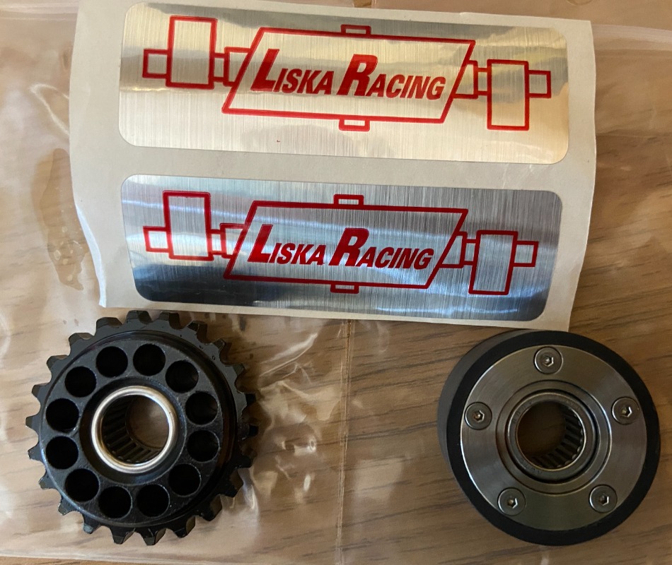

I thought I would treat the bike to these while I had the head off. Not cheap with customs import duty and charges
