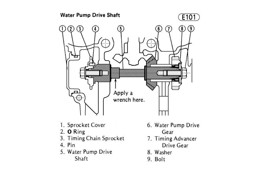

Re: water pump shaft removal?
3 years 10 months ago
Thanks, I have that shaft (the grey timing shaft) removed already. The nut I'm trying to remove is the one going forwards (between 5 & 6 in that image. Unfortunately the nylon bevel gear (part 6) cant be removed until after the impeller shaft comes out.
I googled a few images and it does look like access is much better from the underside so the barrels are coming off. New base gasket and 'O'-rings going on order too. Not looking forward to battling with the rings going back in
