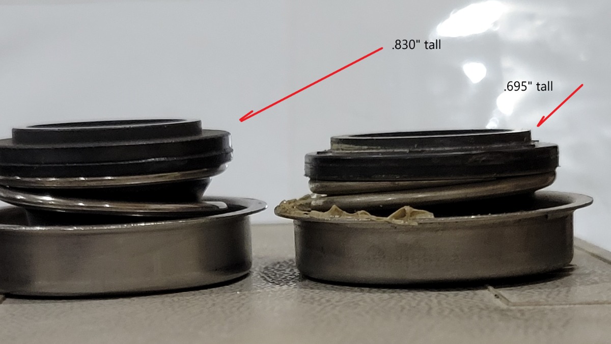

Received 2 mechanical seals, 2 water pump drive shaft lip seals, 2 stainless steel circlips for the water pump impeller, and 2 water pump impeller o rings from
www.zed-parts.com
. Well packaged. They shipped via Royal Mail which transfers over to ( in my case) Canada Post. From time of shipping to final delivery - 13 days and no duties 96 £ ($164 CAD)
I was previously concerned about the possible height difference between the stock seal and the seal offered by Zed-Parts. When discussing what they had available, they told me that the stock seal as new was .740" tall. I measured my used seal at .695" tall (shorter by .045") Zed Parts seal measures .830" tall BUT it has a softer spring meaning after all is said and done, seal face pressure difference would be marginal. Looks good to me and as previously noted Zed Parts have just had their 3rd batch made up of another 200 seals.
