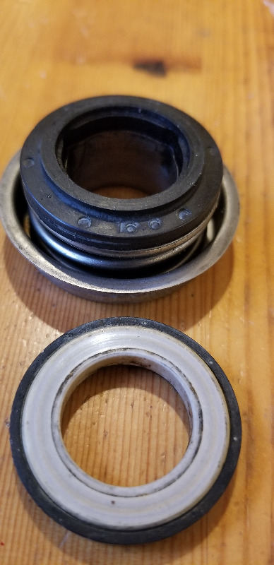

3 years 13 hours ago - 3 years 13 hours agoOld Seal Pictured below. Does seem to be some wear. There was no evidence that it had ever been replaced (I got the bike with about 5k miles on it) yet there was black silicone sealant used on the seal components - I've never seen black sealant used on another Kawasaki ???All's well that ends well. Glad to hear you're sorted out.
Looking forward to the day when we can "service" a leaking seal at home by ourselves and not have to rely on skimpy availability of replacements.
Sometimes I wonder if the initiation of a leaking seal is a consequence of old antifreeze that's worn out from a PH perspective or possibly caused by using an antifreeze not compatible with the metals of the engine. Too many variables that could initiate a seal leak.
Some of my experience with antifreeze relates back to the days when I had Ford Power Stroke diesels and the need to check the PH of the antifreeze every 50,000 K. Typically you would have to add a PH balancing additive to correct the PH but you could only do that once. Then if required again, it required an antifreeze change out. Failure to do this and it usually would cost you a head gasket replacement a job in the $4k range. The cab had to come off to be able to remove the cylinder heads. PITA and not something able to be done at home.
There was lots of brown crud in the 'T nut' (for lack of a better term) cavity that the impeller shaft fits into in the impeller. Not sure what it was or where it would come from.

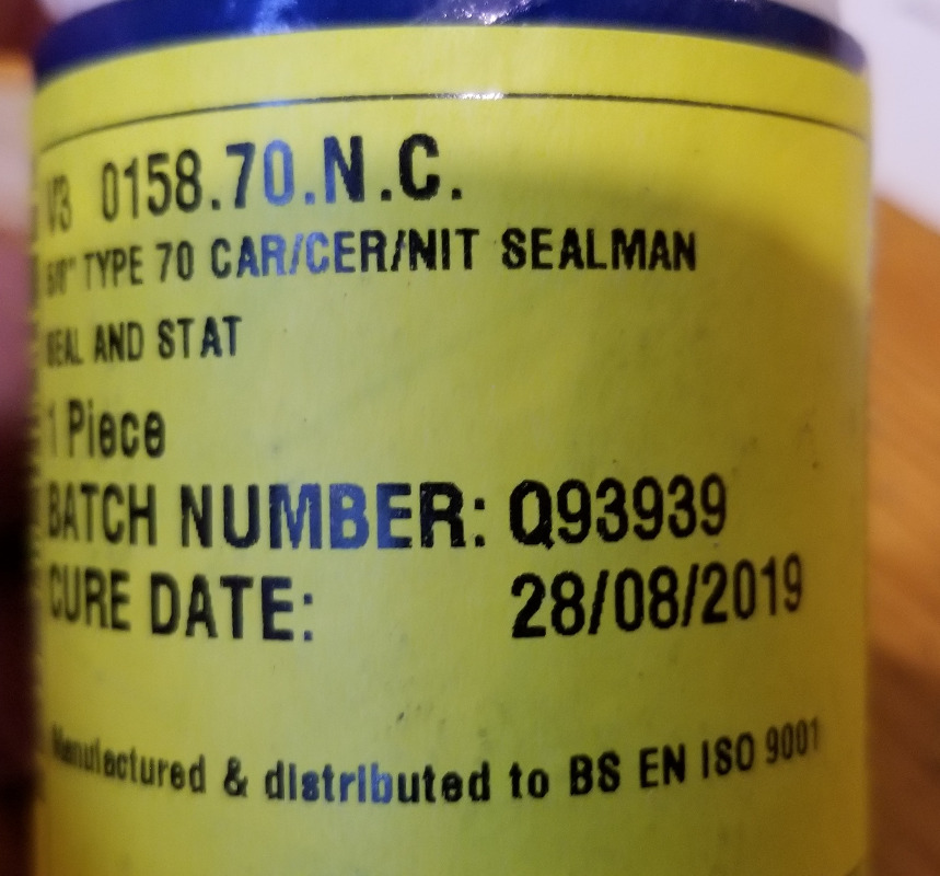

The container for the replacement seal is also pictured.

The new seal package with the part #- It's a very standard 5/8" seal with a carbob rotating seal and a ceramic stationary face. Stainless steel springs and a viton o-ring. this is a common mechanical seal used on most swimming pool pumps.
The brown crud you found may have been residue from the previous owner trying something like "Bar's Leak" to seal up the leak. Bar's Leak is a coconut shell fiber based coolant sealant and it's dark chocolate brown in color.

2 years 11 months ago - 2 years 11 months agoThat 'dark chocolate brown' colour does describe what I found, but there was no evidence of it anywhere else in the cooling system. I've flushed the cooling system out twice (three time including this seal replacement project, although I didn't do much of a flush this time) since I've had the bike and never got anything out other than old antifreeze.Lots of interesting info here Bucko. thanks !!
A question for future reference: Is the tin can part of the seal, that's pressed into the inner cover along with some silicon sealant, supposed to separate from the rest of the seal? I could separate the rubber bellows and spring bits easily out of the old 'can', but I was reluctant to try that with the new seal, however, doing so would have made installing that metal can in the inner cover easier (I didn't have the right size socket to press the can in place so had to get creative with some heat and PVC tubing).
