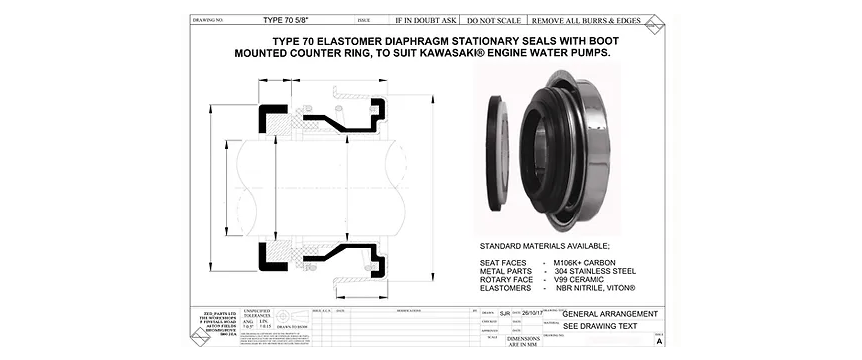

This is a design drawing from Zed-Parts website of the mechanical seal. You can see the bellows that seals the carbon face to the metallic housing that gets pressed in to the aluminum seal housing. This really is a complicated way of sealing the stationary seal face (the carbon face) to the housing. Instead of a stationary face with an oring between the outer diameter and the housing, in this design there is 4 seals that have to work in order to seal the stationary face to the cylinder block. There's the seal between the metal ring of the stationary seal, both ends of the elastomer bellows and the oring between the seal housing and the cylinder block.   There's also the seal between the rotating face and the impeller and finally the seal across the seal faces. So in total there are 6 possible failure points in this seal design.
In most mechanical seals the spring loaded carbon face is the rotating element and the ceramic or silicone carbide face is the stationary element. The carbon face is built in to a cartridge that's fixed to the rotating shaft and the stationary face is mounted in the pump housing. so in a standard design ther's only 3 seals to possibly leak. An oring between the rotating seal face and the shaft. An oring between the stationary seal face and the pump housing and finally the seal faces themselves.
Do I think it's ok to replace the seal without removing the metal cup of the stationary seal from the seal housing? No. You would be taking a chance damaging the seal between the metal cup and the bellows and not a good idea in my mind.

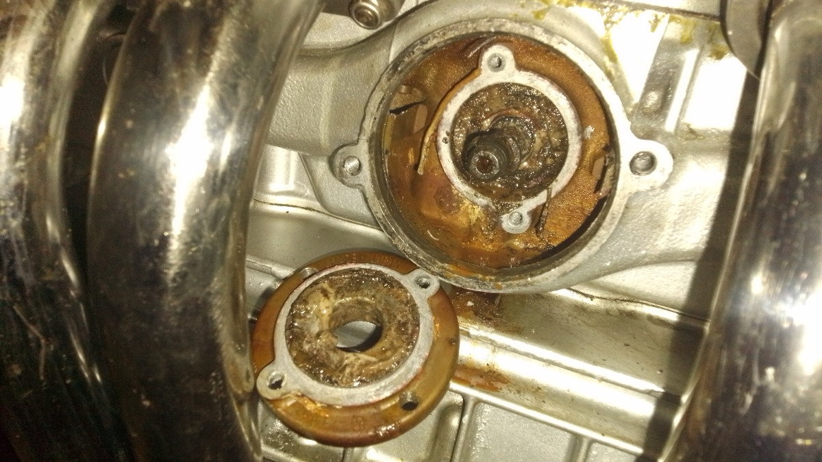

The biggest surprise when buying this motorcycle was finding water in the oil when draining the crankcase. Before lifting the cylinder head, I dismantled the water pump and found the mechanical seal broken, the oil seal was also in poor condition.
I chose to go directly to a workshop specializing in repairing water pumps and they had a seal in stock, cost 12 euros.
I measured the oil seal housing with a caliper with a result of 16-31-9 and bought it at an industrial hardware store for 2.5 euros.
