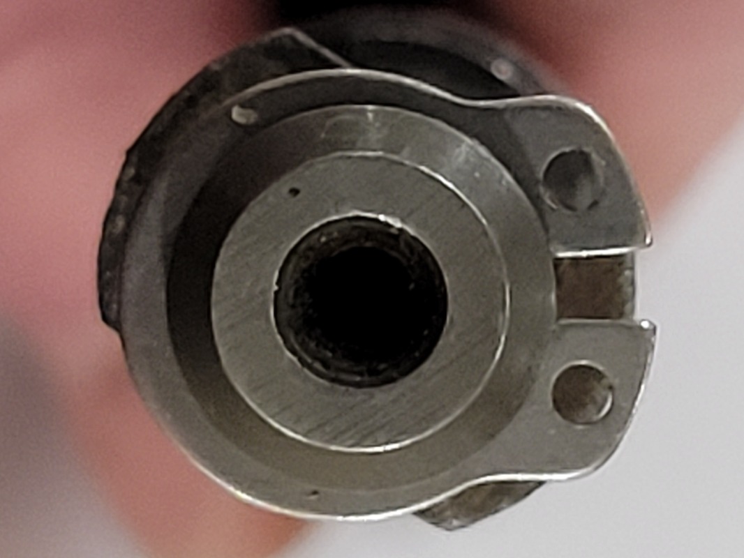

I don't have pics, but the impeller back side has two machined recesses that mate to the shaft. The shoulder on mine is boogered up a bit..
So cleaned it up best I could and reassembled. This time, made sure the tab and slot engagement was good and proper. Not easy for my hands
to push impeller against spring, then wedge it with wood wedges, AND get the circlip on.

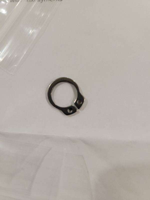

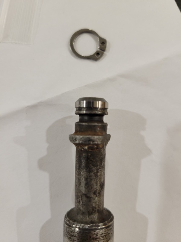

Now, about that circlip- When you have a new circlip sitting in your hand and you look at it, the ears on the circlip are a certain distance apart from each other usually somewhere around .020-.025" and when installed correctly, should look the same and have a very slight grip on the circlip groove but not so tight that you can't spin it in the groove with your finger tip.
What I see in the picture tells me that either the circlip is too small or there is something wrong with the groove. Either the edge of the groove is rolled in or there's a piece of debris in the groove preventing the circlip from fully seating. Whatever it is, you need to figure it out and fix it. I have a set of jeweller's files for cleaning up damaged metal. Another good tool especially for cleaning up circlip grooves is a 6" hacksaw blade from a coping saw. Thin enough for the job.
I figured I needed to support my thoughts with pictures so.......
This is a pic of a brand new s.s. circlip from Zed-parts and as I was saying, you can see the tabs are about .015" apart.

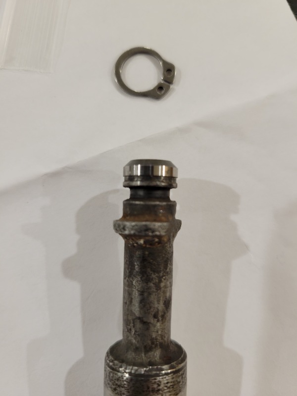

This is the end of my water pump shaft before cleaning the groove there was a fair bit of crud in the groove
After cleaning with a needle file

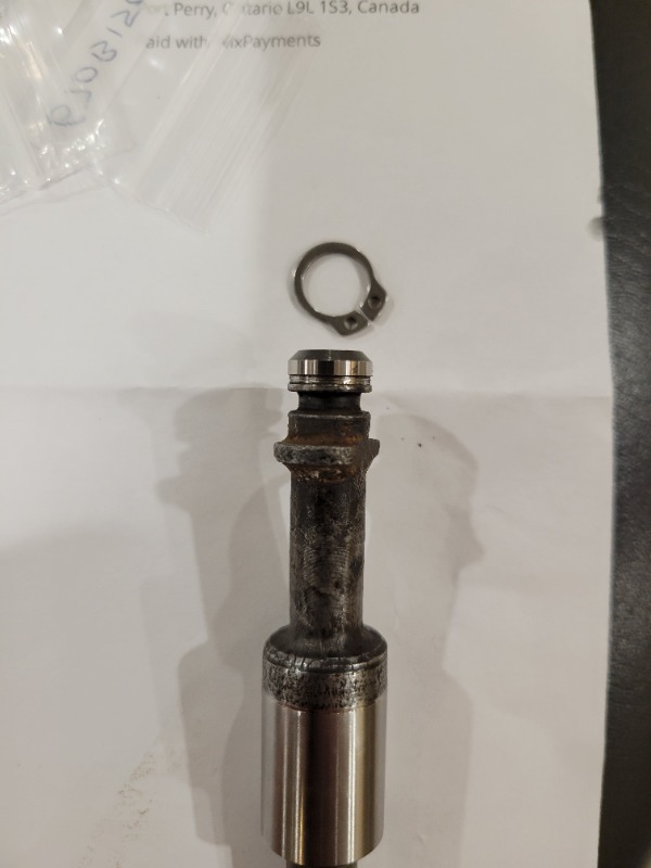

This is the new s.s. circlip installed on the shaft AND as far as I'm concerned the groove in the shaft is about .010" not deep enough in diameter. I can't spin the circlip on the shaft AND I will fix the depth of the groove before I finish this job. I've run across this kind of issue many times at the plant and I'm sharing my knowledge for your entertainment. Hopefully, people can benefit from what I try to explain. This "stuff" is not common knowledge and maybe only a few "tradesmen" would know the proper fitment of something as simple as a circlip. In nuclear and aircraft mechanics, we all know what happens when the small stuff is overlooked.

Time and time again, I see people not setting themselves up for success and when they fail, they get pissed off and usually, they hammer through the task again and an even worse failure happens. "Attention to detail" is not a common understanding for most people. Most guys just plough through and "Get 'er Dun." And the end result is usually a short lived fix. 90% of a successful job is all in the prep including a fundamental understanding of the task at hand.

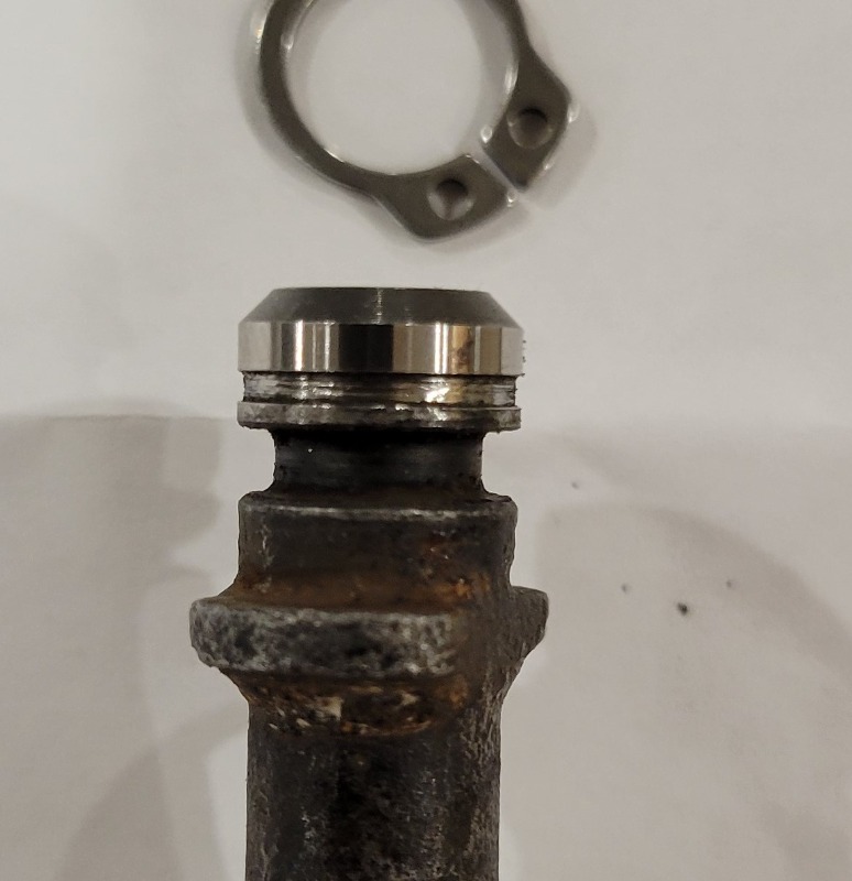

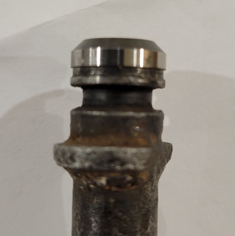

"This is the new s.s. circlip installed on the shaft AND as far as I'm concerned the groove in the shaft is about .010" not deep enough in diameter. I can't spin the circlip on the shaft AND I will fix the depth of the groove before I finish this job. I've run across this kind of issue many times at the plant and I'm sharing my knowledge for your entertainment. Hopefully, people can benefit from what I try to explain. This "stuff" is not common knowledge and maybe only a few "tradesmen" would know the proper fitment of something as simple as a circlip. In nuclear and aircraft mechanics, we all know what happens when the small stuff is overlooked."
So took a closer look. KB is right. Check this out.
Fortunately, nothing is buttoned up. Almost looks like the clip is 'sprung'. Will also check the groove like KB suggested.
I have jewlers files..
Thanks to KB for keeping me on my toes. Sometimes truth hurts, but if one learns and changes... then it's all good.
