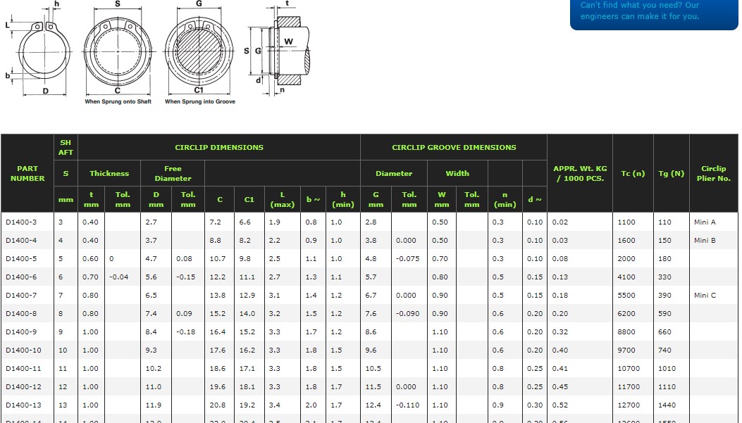

2 years 5 months ago - 2 years 5 months agoEverything about circlips is determined by the shaft diameter the circlip is being installed on.
The shaft diameter of the water pump at the impeller is 11mm.
Referring to the chart we need a D1400-11 circlip
The free inside diameter of that circlip is 10.2mm
The groove diameter is suppose to be 10.5mm
the thickness of the circlip is 1mm
The groove width is supposed to be 1.10mm
This is where things got interesting.
I measured the groove diameter of my shaft at 10.3mm when it should be 10.5mm The groove was .2mm undersized
I measured the free inside diameter of the circlip at 10mm and it should be 10.2mm The circlip is .2mm undersized as well.
Bottom line- the circlip available from Zed Parts is a perfect fit for the water pump shaft even though it is not a standard spec.
If you spring a 10mm circlip on to a 10.3mm groove ( a difference of .3mm diameter), the ears of the circlip will open up by (diameter difference x π) = .3 x 3.14 = .94mm (.037")
If the free space between the ears was .015" and we add .037" we end up with a gap between the ears of .052" (1.3mm) and that's measurable. So you could measure that gap and know for sure that the clip is on properly.
