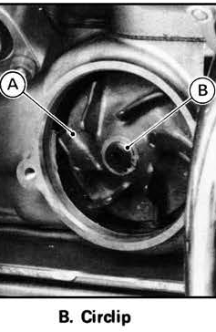

Just had another look at your last post and I see the pic of your water pump impeller installed. The circlip is not installed correctly or it's too small in size. The 2 ears should be butted up almost against one another. Quite often when removing circlip, they get opened up too much and they deform causing them to not completely engage in the groove. I know you installed a new clip but either it's too thick for the groove or it's too large in diameter. Better have another look
This is the pic straight from the FSM and cropped / exploded for better viewing . This what it should look like. Note the inner edges of the ears are parallel to each other.Sometimes what I've seen happen if the shaft is soft, as the circlip is being installed it can cut a slight burr on the edge of the circlip groove and fold it inwards then leaving the circlip not fully engaged in the shaft. If that clip pops off, the impeller will drive itself in to the housing cover, and you'll be on the side of the road calling for a tow truck.

2 years 6 months ago - 2 years 6 months agoWell crap. Got everything re-assembled then read this. Sometimes truth hurts. The circlip was new from de.1300. I too looked at it and thought it was a bit 'off'. But it was secure, snapped into place, and didn't act like it wanted to jump out. I did check the groove, it's clean of burrs.Just had another look at your last post and I see the pic of your water pump impeller installed. The circlip is not installed correctly or it's too small in size. The 2 ears should be butted up almost against one another. Quite often when removing circlip, they get opened up too much and they deform causing them to not completely engage in the groove. I know you installed a new clip but either it's too thick for the groove or it's too large in diameter. Better have another look
Will do the right thing and tear it down again. Crap Crap Crap.

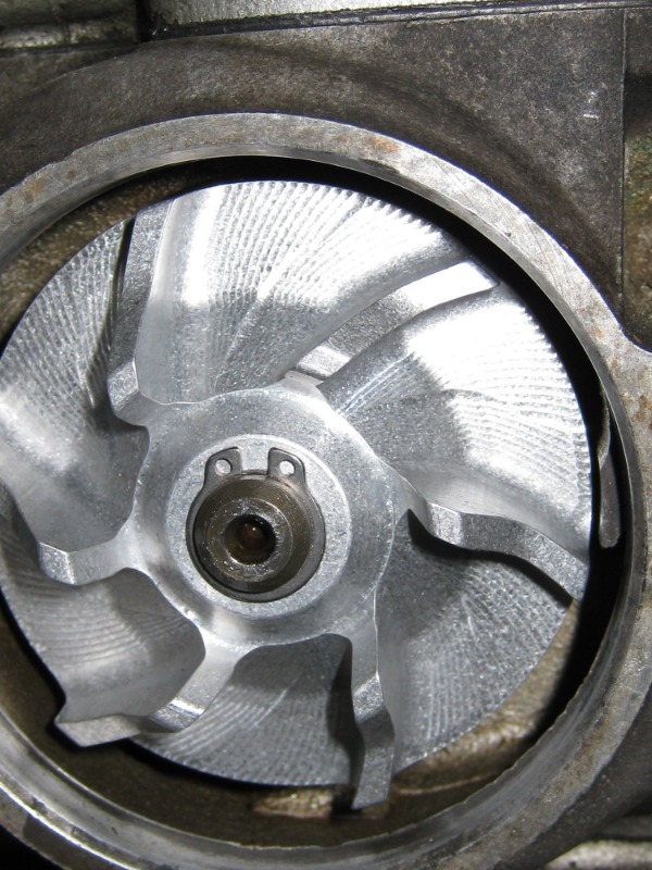

I replaced my impellor and circlip a few years ago but did take some pictures - these items were both purchased from Z1300.de so assuming the specifications of the circlip have not changed, it does look like yours may not be seated correctly - sorry!

2 years 6 months ago - 2 years 6 months agoIf I were to critique this installation Neville, I would have suspected that the right ear was hung out just a tad and I probably would have grabbed a screwdriver and a hammer and given it just a nudge to ensure that the right side of the circlip was fully engaged. And likely before I did that I may have just tapped on the impeller on the right side and seen if the circlip closed up a little more on its own. The left side of the circlip appears to be sitting deeper in the groove than the right side.
In all fairness, the angle the pic was shot on may make the circlip "appear to be" not quite in place. In any event, Don's circlip installation is suspect.
Normally, when you buy a new circlip, the ears are closed and a well fitted / installed circlip will have the ears slightly open like maybe .5mm - .8mm meaning the circlip is strangling the circlip groove and not loose enough to spin around in the groove.
