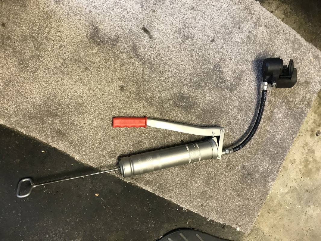

I have found the easiest method for removing stuck caliper pistons is to use a grease gun connected to the caliper pressure feed - most calipers have an M10 fine banjo fitting which is compatible with grease gun fittings. It may be necessary to bolt the caliper back together and refit the freed piston - clamping this in place to ensure that it does move preferentially when you add grease gun pressure.
Its a bit messy to clean everything up afterwards but much safer than using compressed air!
