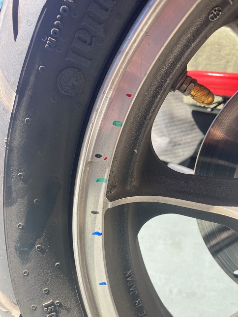

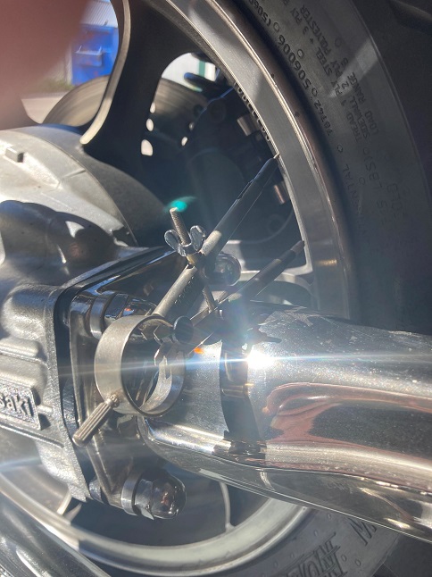

For what it's worth:  My 1300 has 109,000K.  Never had the transmission apart.  It can be shifted so smoothly its like an Automatic !
This is the backlash. Approx. 42mm/1.675"
The colors are as follows:
Red = 1st
Black =  2nd
Green = 3rd
Blue  = 4th
Yellow for 5th doesn't show

Thanks Scotch. That's great!, I'm going to try that today and see how it compares. Re mileage I suppose one can't be sure what a previous owner has done or even if mine still has it's original engine. or clocks. It is still on it's original bore, I do know that.

Well that's strange! I did your measurement Scotch, and also came up with 42mm .  Now I'm really confused.
Maybe I'll take it for another ride just to test the take up clunk.
