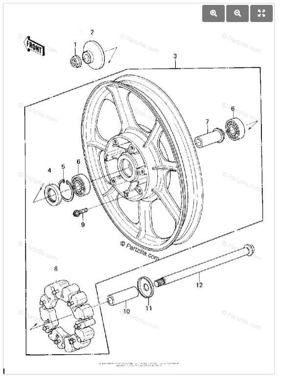

I was hoping it would be the rubber damper but it's unfortunately further up the drive shaft in to the engine.

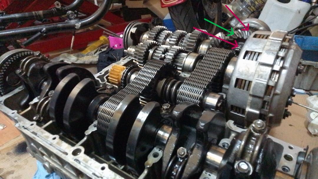

Thanks KawaBCN, I examined the cardan and it seems to operate very smoothly with very little slack. But with the cardan removed I rocked the driveshaft back and fourth, there is a lot of slack / play, on the engine side, but the universal joints are good.

I'm sorry I don't have a better photo.
Where the red arrows point are two bearings that may have worn out, causing the pinion to move, with the green arrow causing clearance between pieces.
You can remove the oil pan and use an endoscopic camera to see a possible failure before disassembling the engine.
