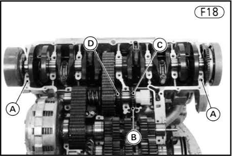

There are 2 drive chains in the transmission which can get sloppy over time, depending on a number of factors such as oil change frequency, type of oil, type of driving etc..
The primary chain runs between the crankshaft and the secondary shaft. (see page 189) 22mm slack max
The secondary chain runs between the secondary shaft and the drive shaft (see page 191) 21mm slack max.
These are the service limit measurements in the Factory Service Manual to reference to.
Slack in the primary chain also has a big effect on engine camshaft and ignition timing since both the camshaft drive chain and the water pump/ ignition drive chain are driven off of the secondary shaft.
