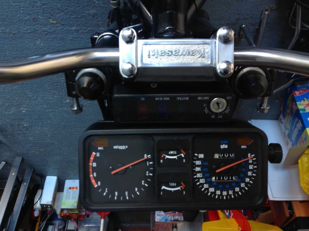

Binnacle and warning panel back on. Bars have been polished. All connectors and wires cleaned and looking ok. The top and bottom yokes have been painted as have the headlight hangers. The head bearings seem ok so I have left them alone for now. The fork seals also seem to be ok so I will give them the benefit of the doubt- for now.

:silly: :silly: :silly: :angry: Different iPad and still upside down with camera the right way up. Sorry.
