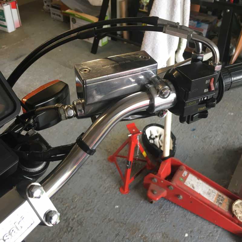

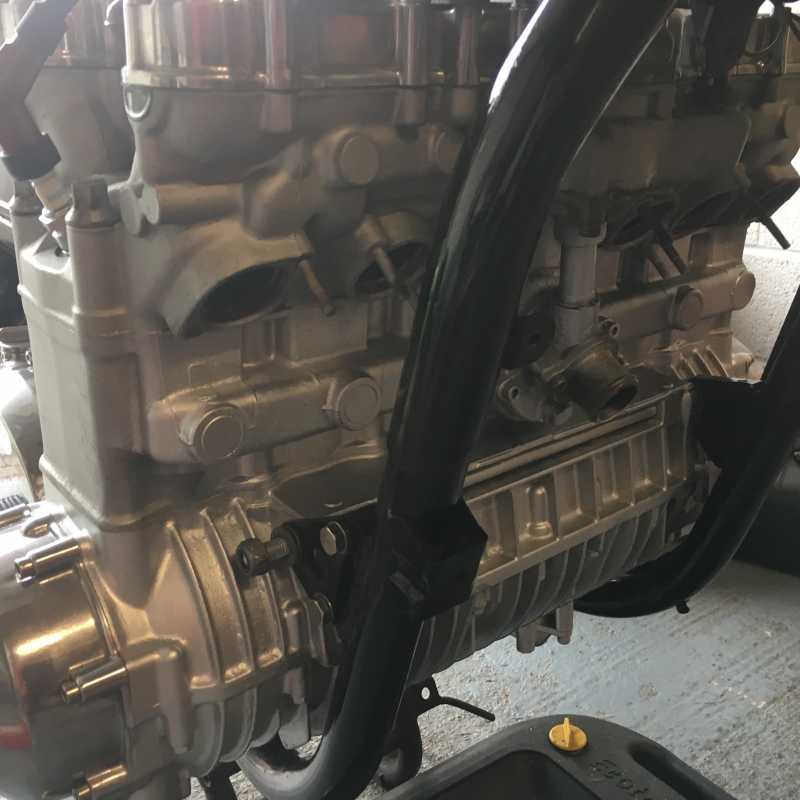

Master cylinder polished and all switch gear stripped, cleaned and rebuilt. The engine face and hangers painted in VHT.

Looking good !
What colour have you decided to go with on the paint set ?

I am going for 2 k lime green from APW.

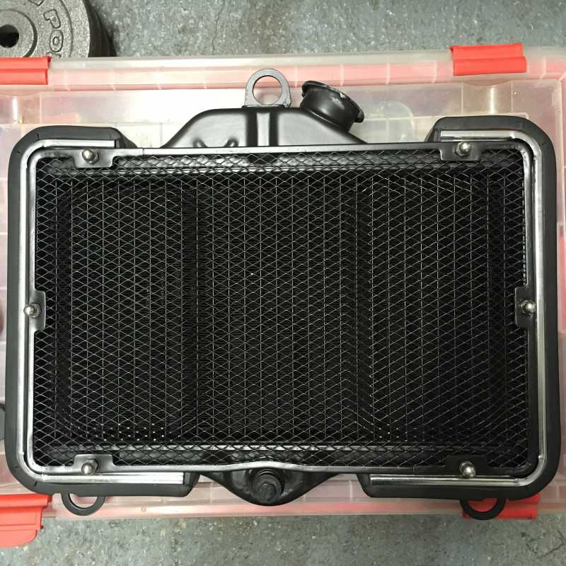

B) Just finished the radiator and I think it has come out alright. I spent hours rubbing it right back to the metal and then sprayed it with Rustoleum high temp satin black. The inside of the rad is in really good shape so I have left it as is. Here is the before and after.

Rad looks great!
