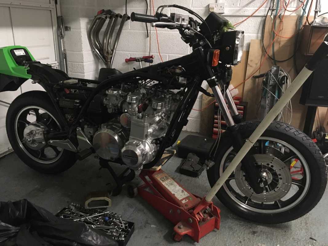

You sure do nice work. Love where you're going with it.

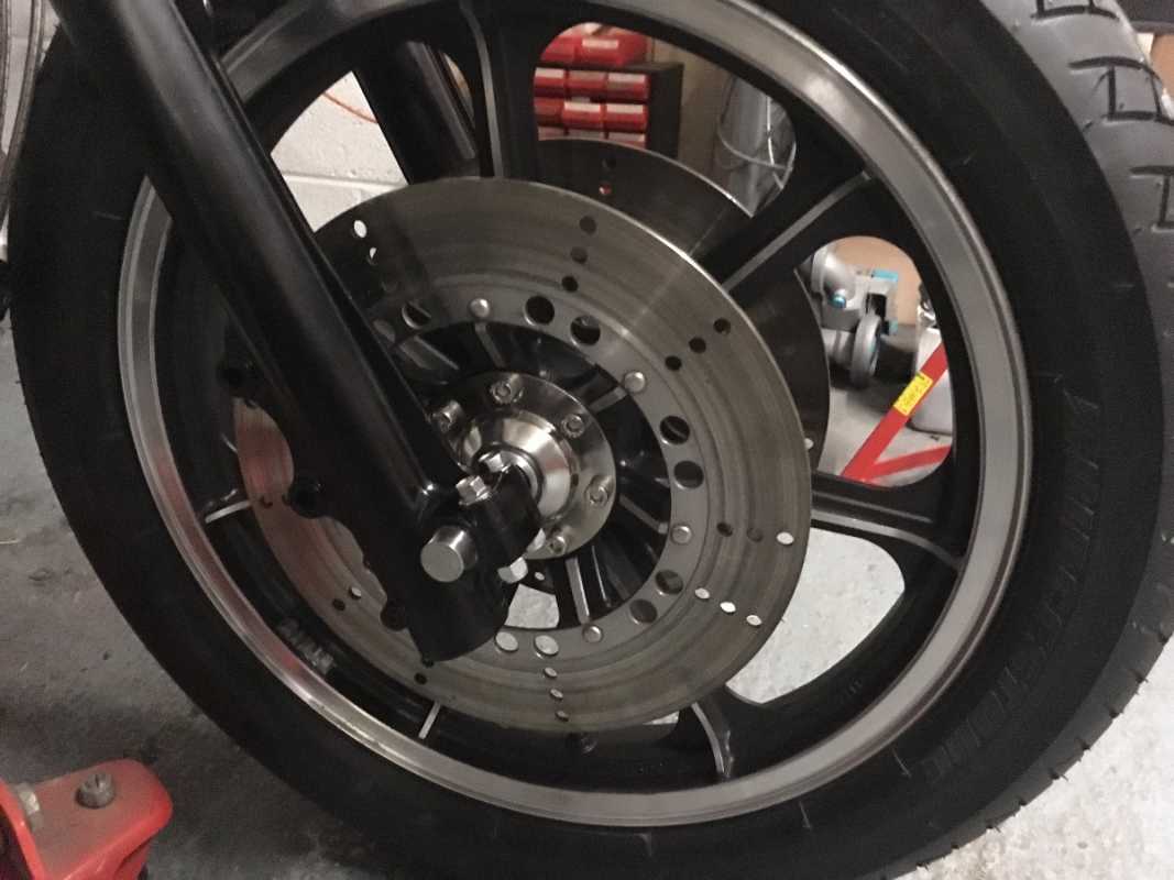

Just a word of caution and something I would ask you to consider. You mention changing out the disc bolts for stainless. Stainless fasteners are usually fairly soft due to the nickel content. If you've ever experienced thread galling, it's due to the softness. Take a ball peen hammer to a piece of stainless sheet and just see how soft it is. I suspect the bolts that hold the brake discs to the wheel hubs are grade 8 fasteners which are very tough. I'd hate to see you brake hard and have the bolts shear off and then no brakes. Just check the grade of bolt you used in this particular application.
