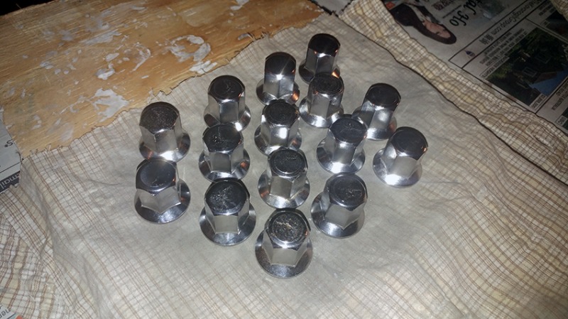

Superficial rust, grime, they just looked ugly. One and a half hours later, dish-soap, brass brush, and metal polish, and of course what is commonly known as the 'elbow grease', they look like new. A small think but made me so happy. Almost feel like I'd like to put them on a string and make a necklace! hahaha
This is what I am doing. While big stuff holds me back, I am working on having a stock of ready to use inventory of small parts. It will make a world of difference when putting the beast together.
Cylinder head nuts:
Cylinder head nuts:

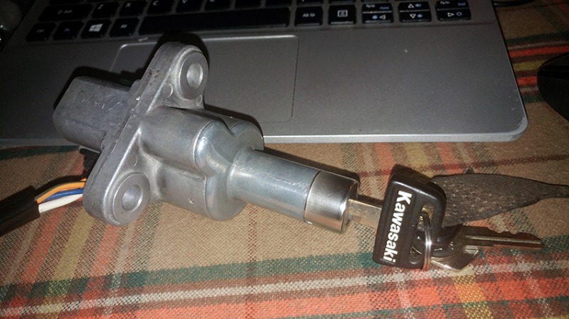

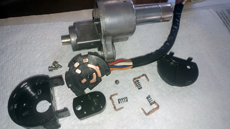

Another small meantime project. Got to the guts of the ignition switch. The details how to get there are not very interesting, the main reason is to have a display of what it look like. Clean, grease, put it together.
All back ready to fire up

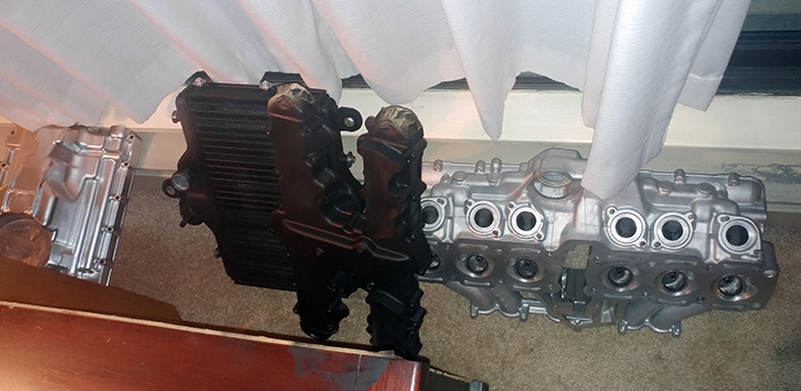

Here is my sixth's floor's bike's private performance conditioning place. The humble super heated electric element which keeps me warm in winter, when in direct contact just placing a piece of metal on the cover, gets really super heated. It is way beyond the water boiling point. Moving the painted parts back and forth between this life like engine operating temperatures and cooling them down, I can already see things get sturdy.
Here, parts baking just where they belong
For now that is.
