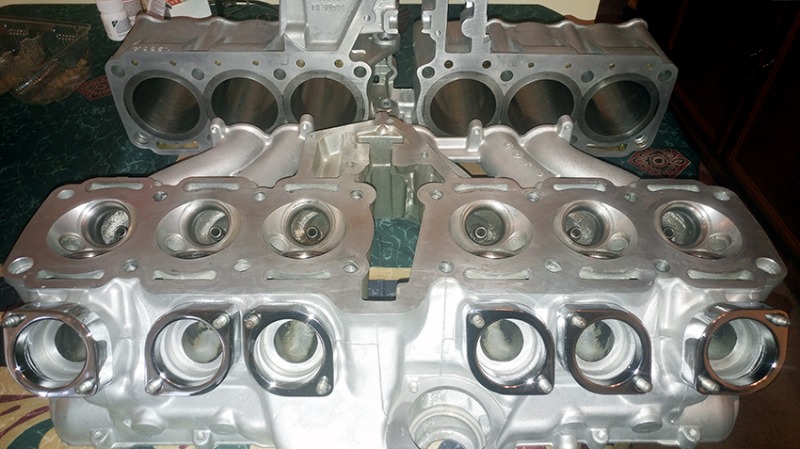

Went to the automotive machine shop where they pressed in the cylinder #3 sleeve and deglazed all the cylinders. The replaced sleeve was sticking out a tiny bit above the others, so I asked them to press it inside a bit more and make all leveled. Done. The cylinder block is ready for a bit of more cosmetic polishing, bathtub cleaning, and finally a coat of paint.

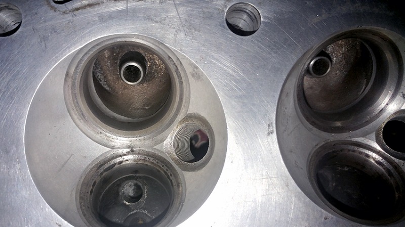

I also took the cylinder head in for service. After bead blasting I spent half an hour rinsing it in a bathtub. Still residue of beads visible here and there. So I asked them to first give it a good hot bath, remove carbon residue and make it clean.
Ready for a trip to a machine shop.
Next they will replace the chipped intake valve guide on #3 (I supplied original Kawasaki guide), and check all guides if more replacements needed. My guess is they are fine, except maybe one (I gave them two just in case).
The seats look ok but most, if not all, will need a slight grinding to get rid of the scratches. For now I just asked them for evaluation.

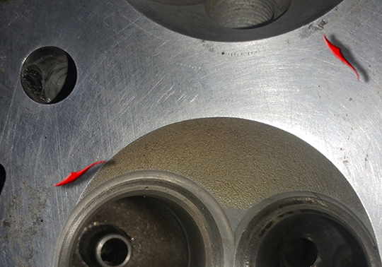

Last thing for now, the cylinder head will be resurfaced. It is pitted in a few places and there is no way around it.
