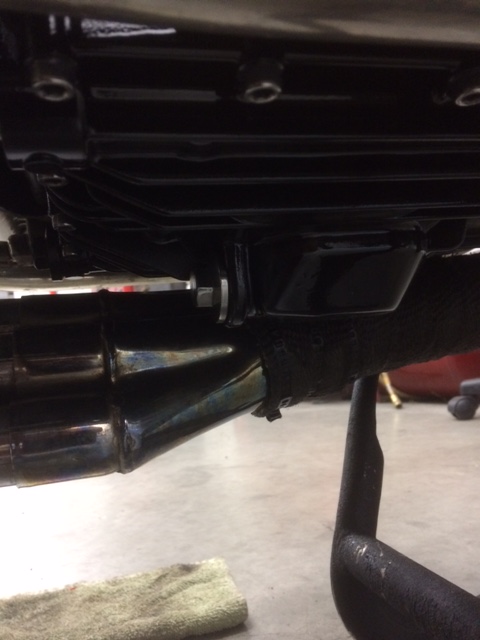

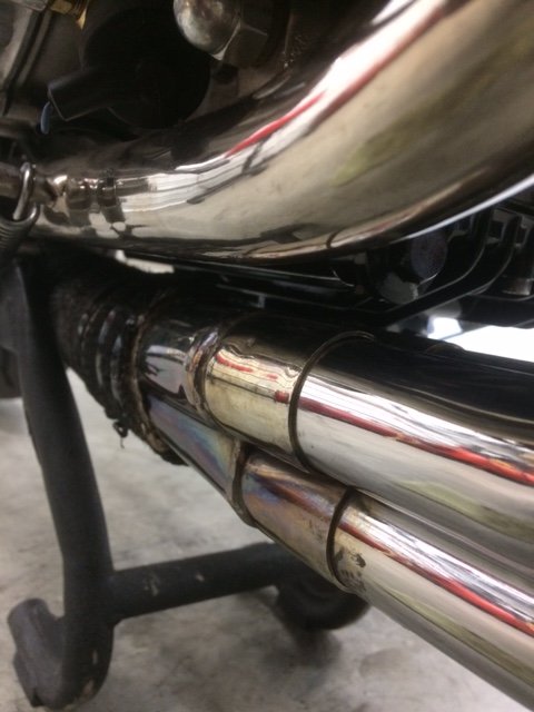

So from "what's left of my memory" and in no order; So, yes, the "well" for the choke pick-up tube has a metering jet in it as does the end of the pick-up tube. I can not give an explanation as to why 2 metering jets. The one in the pick-up seems obvious. The one in the bottom of the well - ?

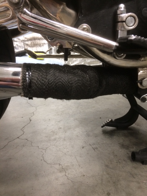

The header collector is in 2 photos. I "wrapped" to the outside bend of the D.G. (Makers name) header because it also passes under the rear brake M/C. I figured - "Why not".
Take a close look at my center-stand ! You should notice something! Also - With the mod required (on mine at least) to allow the stand to be used with a D.G, it retracts up almost out of site.

I see, the DG pipes are a custom replacement. That's where the discussion about polishing the pipes come from. Thanks to which, now I know my stock pipes are double walled.
Looking at the center stand, I see a bundle of pipes going through it in a bundle close to the middle of frame. I think my stock is not as busy, or at least differently laid out, and further to the outside. For now I am staying with stock - except for some chrome problems it is solid.
