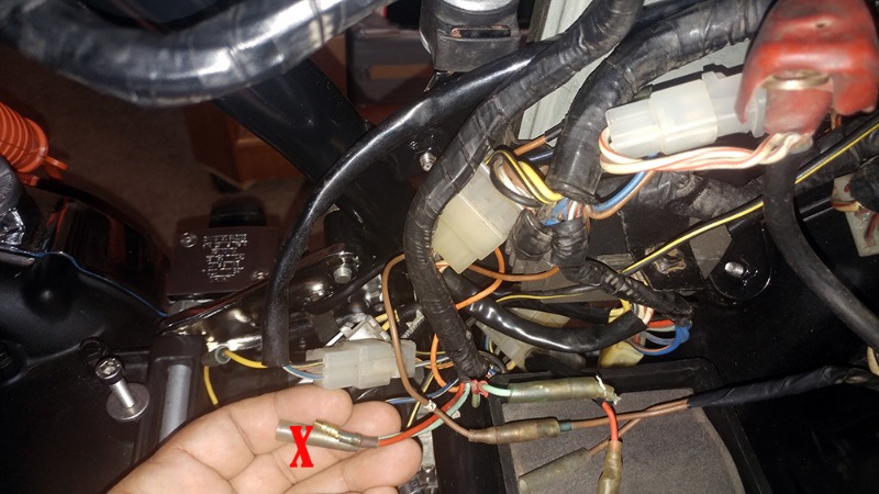

mizztheman - in your last photo, where does that top black/yellow wire connect to? I had one attached and can't find it. But I connected all the other ground wires, so I am tracing this one.

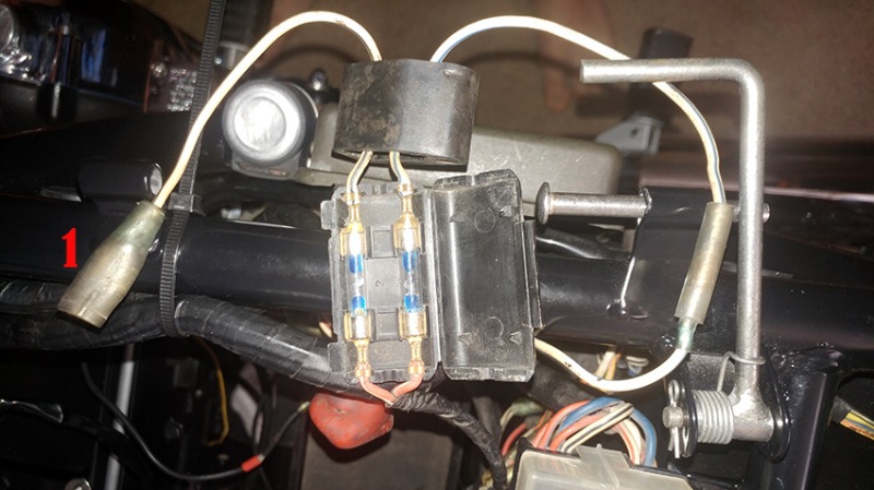

Now, this fuse box. I've seen one end connected to ground, but it had a different color. Where does this one marked '1' in my picture connects to?
And here, these two light green and red - they come from the branch of main harness and go up the frame towards front. What do they, marked 'X', connect on this end?

Stan, The light green and red go from the signal cancel unit to the distance sensor inside the speedo, your mark X. Th fusenbox is extra, meant for accessories, leave empty if not needed.
