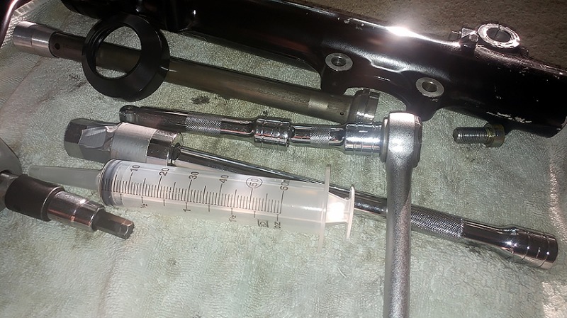

A recap: front forks removal and installment.
This method is the least expensive and troublesome in my opinion. Plus saves space because you'd use the tools you probably already have, and the only extra left will be a small coupling.
The only needed extra expense, is a 15/16 inch (24 mm) plated rod coupling nut from a hardware store (Home Depot in my case, about $4.50 Canadian), 60 cc syringe (1.49), plus a piece of duct tape.
Tools: 10 mm Allen key socket and 24 mm socket.
I drained air, removed the top nuts (27 mm), drained the oil. Used impact gun to loosen the bottom bolts. The pistons started spinning, so I used 3 feet long 1/2 inch copper pipe at first to remove the first piston, because I was still learning and didn't have my 'specialty' set up. Tap the pipe into the piston, hold it with wise grips, undue the bottom bolt, pull the piston out.
There is no need for copper pipes if done using the coupling nut.
I guess pictures speak for themselves. This set up is solid and easy to use disassembling and assembling. The socket I used was 24 mm 1/2 drive, and for the bottom bolt 10 mm Allen key socket 3/8 drive with a 1/2 adapter because I used a 1/2 drive impact gun to undue it. It's not necessary, but easier. When assembling, it's easy to use it with a torque wrench. 391 cc of 15W oil and 9 psi air pressure afterwards is what I chose.

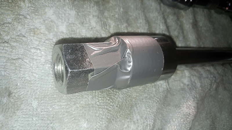

As you see, I used a three extensions and a duct tape to hold the coupling and the socket together. The tape actually plays double role: keeps the coupling and the socket tight together, and protects the inner walls of the fork from scratching. The rest is straight forward.
Spring service limit 580 mm (mine is 590), disassembled and completely dry fork oil volume 391 cc (360 cc if just oil change), 2 bottom bolts torque 27 ft.-lbs (apply non permanent liquid gasket to the gasket), 2 top bolts 16.5 ft.-lbs, air valve 104 inch-lbs.
The exact amount of oil measured with a 60 cc syringe purchased from a medical equipment suppler.
