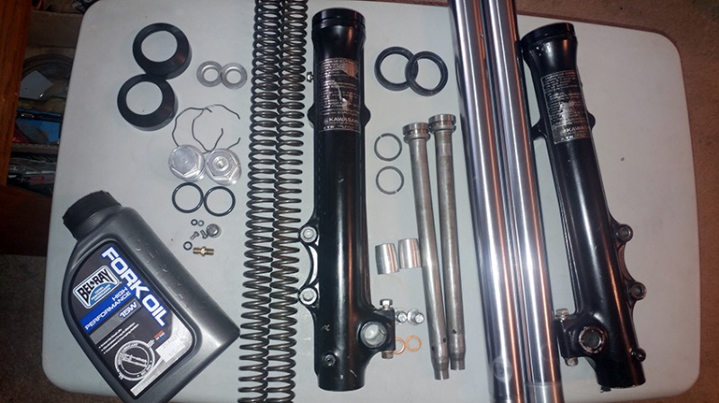

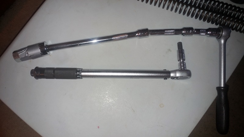

Back to the front forks, a couple extra photos. Installing and setting proper 27 ft.-lbs. torque on the bottom bolts was a breeze.

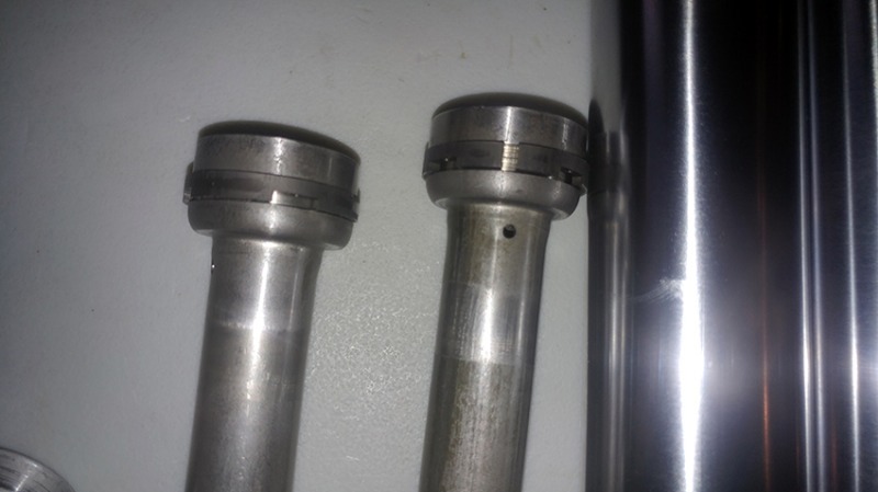

One last thing - I strongly suggest checking the 155.5 mm oil level (no springs and forks collapsed). Tape the air equalizing holes with electrical tape and check the levels. I used a hex-saw blade - marked the top level and the 155.5 level. Held the top with small vise grips, [placed on the forks top, and did a similar to oil level checking like we do in cars. I was quite surprised how much had to be adjusted, despite the service manual stating a bold cc number.

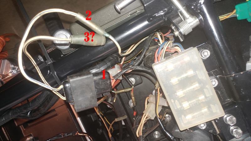

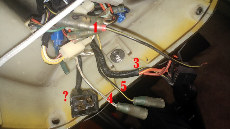

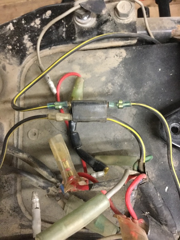

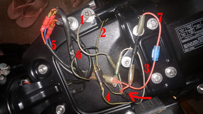

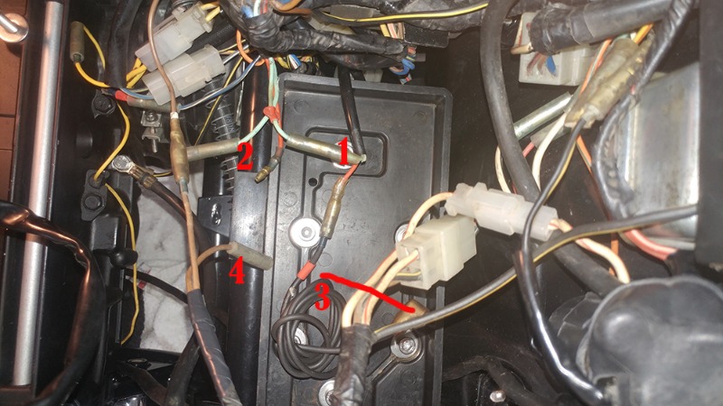

A few unsorted connections.
The rear was a mess and nothing there. Just wondering if these connections look right.
The front - I have an idea but need opinion about hooking up the turn signals. The headlight is #3, the rest I think the signals. Except the '?' which I don't know what it is, but I suspect it goes to a fairing with extra goodies. Front signals have 3 wires - 2 +1 ground. Here, #4 and #5 would make sense + the #1 as supposed ground, but both 5 and 1 have the same color pattern, confusing me.
The two brown wires come from one harness, but one is not connected. No idea where it goes - there was nothing on the other end.
Same two pairs of light green and red wires. One connected, the other not. #3 goes to the oil sensor in the oil pan I think. But where the other pair identically colored goes?
Below - no idea where the '?' should go.
Any help much appreciated!
