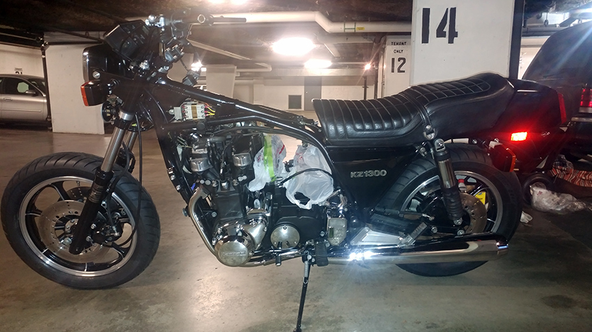

Posting, despite the message frame still out of whack.
Tomorrow the main thing: radiator, front fender. And a few top end wires and hoses sorting out.
Still working on the fuel tank attachments: petcock and a missing fuel level sender. I bought a couple unrelated units, one of them seems to be fitting. The measured resistance is within specs, and I calibrated it preliminary between empty an full. I just need to drill the holes to match those on the tank, and I am not planning on running down on fuel anyway.

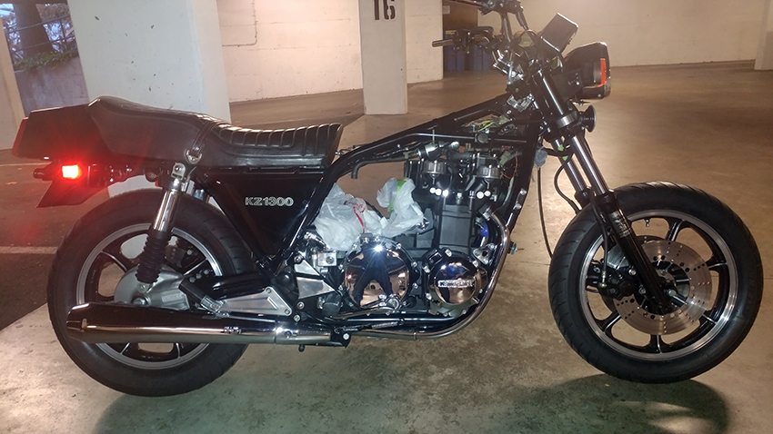

Wow that's looking really great. I see you look to be using the rubber brake lines any reason you didn't go with stainless steel ones? At least they look different then the ones I have if they are SS lines

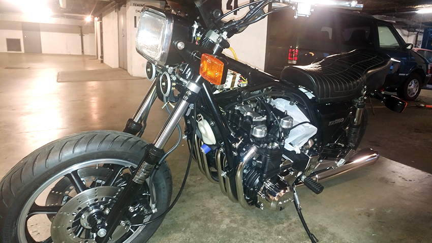

Does look great Stan, like the black engine cases.
Are your exhaust cans original, or did you replace?
(looks super-shiney!)

the bike is looking magnificent. Have any of the other users of that car park commented on the bike?
