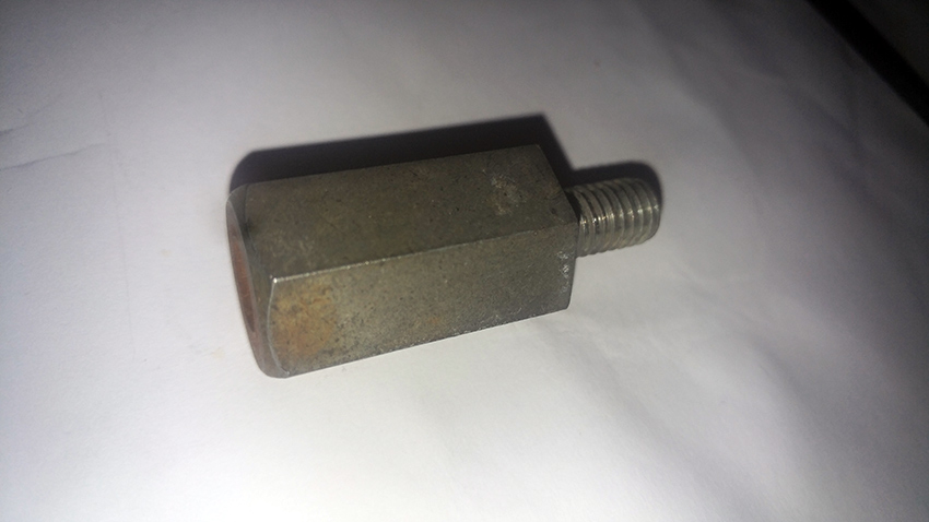

I think what RChaloner is referring to is a "coupling-nut" which will not fit for use on the front due to the lack of space where the bolt passes along the channel in the engine case. But they are handy....at times!

The one already on the bike came with a proper length coupling already attached (female - female)
The one below is female - male. I think this is what you refer to guys. It was attached to the frame in the back for a reason I don't know. But one like this would be perfect, given it had the right thread size.
I had a hell of a time finding a nut fitting the oem mounting bolt (was missing), and I had to purchase a whole set of brackets and mounting bolts just to salvage one nut! Good thing is I was lucky again to get them very cheap. I might chrome plate them one day and replace those I have right now.
And yes, scotch just said it - it's very tight there. I haven't measured anything, but perhaps with some grinding something like this would fit.
