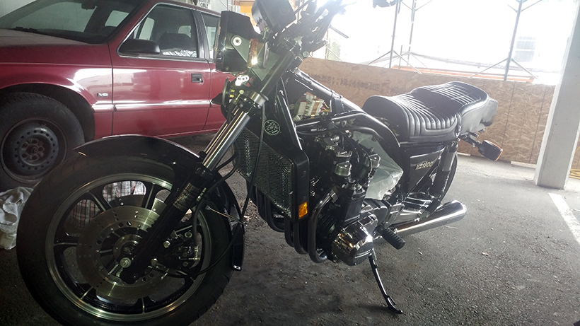

Bike looks great Stan !

Lights work, all fluids are in, engine turns over nicely, no leaks! :)
Just working on the petcock and fuel level sender.
