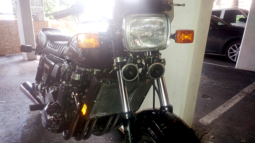

I already tested the horns on some a-hole driver, and it's loud! I think having even just one is plenty. Although I will be installing another one.
Here a photo of the two Honda horns.

The bike looks superb in that photp, Stan. It's a good camera angle. I can't get over how good that hulking great engine looks in the black finish.
