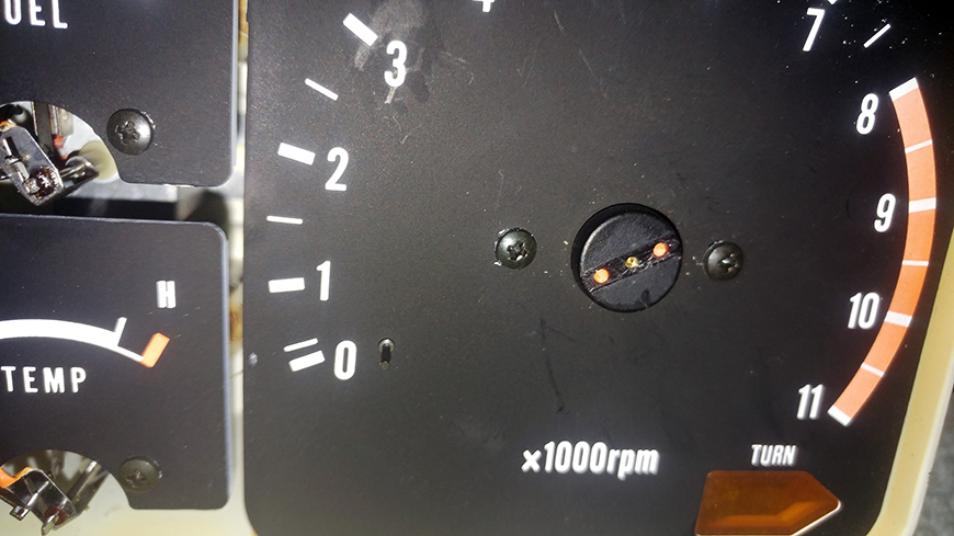

Managed to remove the old needles, and it looks like they had a couple of 'nipples' to prevent them from moving.
The replacements I got from Lare don't have them. Do you guy just used crazy glue?

#21246
Got things sorted out with Laurie, and with super glues, the needles will bond well with the orange left over cut off studs left behind. As plastic bonds well to plastic, plus the bonding to the center black disc. A note of caution, for the record, don't try to remove those discs. Just use a scalpel like blade to cut off the old needles. By experimenting, I found the center not being bonded. Best what worked for me was a very narrowly pointed tip of an Exacto blade. It went easily underneath the mid section, then pushing to one side cut through releasing one end, then reversed cut through the 'stud' and release the other end. The old needle came off. Next to find a good glue and the speedo will be assembled back together and mounted on the bike - after the brake in phase. I am going to rewind the odometer as well, to have it reflect on the real mileage and match the original odometer. Do I just connect an electric drill to it? Not feeling bad about this at all, since everything about this bike, my bike!!! hahahah :) is well documented. No cheating! I think my bike is very unique in comparison to some shady deals because the whole process from start to the finish, and where it's now, is very easily traced and described.

StanG wrote: Managed to remove the old needles, and it looks like they had a couple of 'nipples' to prevent them from moving.
First, I'll start by saying I haven't done this ( needle replacement) job before so take what I have to say with a grain of salt.
What I know about speedo and tach clocks.
There's alway a small amount of tension on the clock spring when the needle sits at the needle stop pin. If you look at your picture and draw a line through the 2 needle tits, you can see that the line will fall below the needle stop pin. If you glue the new needle on the disc with the needle against the stop pin, the indicated rpm will be off because the preload will not be on the clock spring. Just be careful.
Odometers don't like to be "spun" with a drill. The gear pack is too sloppy and I've heard that it's possible to break one of the teeth off of a gear or one of the teeth off of a counter disc. It's better to just pull off the drive gear on the odometer shaft just enough to disengage the gear pack and then rotate the clock dials with your fingers.
Speedo drive cables might spin at 200 rpm. Ramping the speedo head up to 1800 rpm with a drill and then odometer gears will make a hell of a noise. This you can trust me on I've done it for a few moments and then decided to "change my ways"
