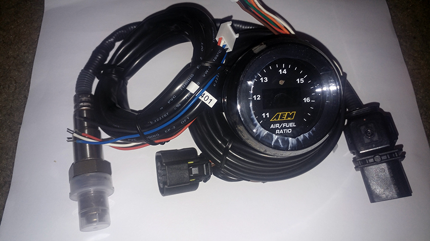

This A/F sensor has been sitting on my shelf for two years maybe. Time to do something with it, and that is making a diy exhaust analyzer. Quite straight forward actually, just need to get a few small things. Stay tuned.

I think that would a first for this forum and the idea is outstanding ! Results will be very interesting !

I just called Kawasaki and they said they are not equipped for checking real A/F ratio. Hmmmm.... As an idealist, I've been obsessed with needing one banjo per pipe. But that's juts plain silly. Just for the sake of an argument, following on your 'by ear' one by one adjustment listening to the overall sound, I can't see anything against real time A/F ratio reading adjusting one by one and checking the overall ratio. Makes sense! And that's what they use on a dyno. And it has to be more accurate! I just need to test how deep I can shove this diameter 'enema' and go from there. Cut and lengthen the wires, insulate, attach the sensor to a stick, wrap it in heat resistant blanket, connect red to a 10 A fuse an power and black to ground, insulate the other optional output ends, and voila.

Re: that A/F set up. Kawboy reading this, with your experience? Thinking of another option, which would make things easier perhaps. Stick a pipe inside the exhaust with the sensor at the outside end of if, instead of sticking the sensor as far as possible in side the exhaust. Yes, I know very well that the closer to the source the less 'contamination', but would it really make such a huge difference when done properly? (good seal). On the other hand, minute changes/impurities give inaccurate readings, and we are after accurate. I am leaning towards shoving the sensor as far as possible close to the collector, instead of shoving there a pipe with the sensor on the other end of it. Just thinking aloud, no need for lectures! hAHaha What would your thought be guys?
