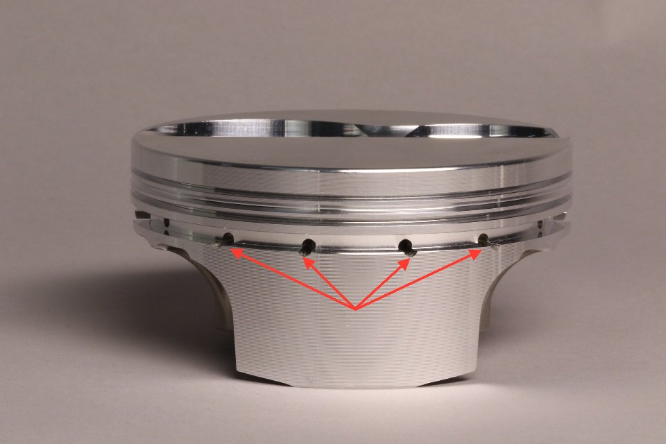

I can see the logic on the effectiveness of the extra holes, but Kawasaki had them in the same place for the injection pistons and Stan has them in his carburettor version (1982), so they must have had a reason... anyway, they are there now.
I was also very surprised they drilled them by hand... They are a professional outfit with a good reputation and they did the head very well, but I had expected them to pillar drill whilst holding the pistons in a clamp of some sorts... I think the is why they did not charge me... they knew if was not a very good job. But I guess no real harm done.

Not to keep writing a book about piston holes, haha, but a final remark from me.
Frank883:
That is a partial truth though. If you have those pistons in hand, both older and later pistons so have holes in the groove. BUT - the later pistons have additional holes drilled partially in the extra bevel. So, they have a total of 20 holes, instead of 10.
I am borrowing a pick here from Wiseco website:
Here is what they have written about it:
Their placement corresponds directly to where the 'extra' holes in the later KZ1300 pistons are. If the theory is that both placements offer similar performance, I find it quite logical to assume that adding extra holes overall increases efficiency. In other words - more oil exchange by volume desired and achieved. Plus, the bit about more flex is something new to me and interesting.
Here is the whole write up at Wiseco website:
>>>>> The Science Behind Piston Ring Grooves
As to the cylinder block gasket, applying sealant would be on one side, the bottom. I did apply it but conservatively, and carefully especially around the oil passages, after first applying some engine oil to the gasket.
Frank883:
But those holes will have no real effect. Oil holes belong in the groove. .......You can google images for “piston oil holes” and see that these go in the groove.
Most pistons use drilled oil reliefs at the back of the oil ring groove. Some have slotted holes that open up when the groove is cut. They are equally effective but some designers feel they allow more flex in the ring land.
