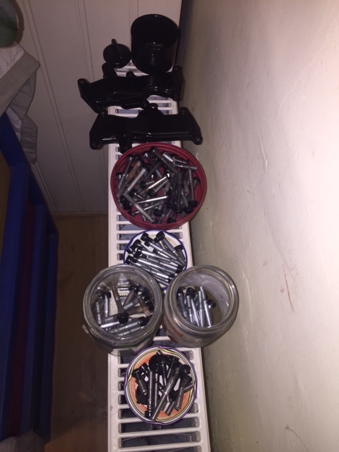

Other thing I have been doing is painting all engine cover bolts black... very tedious, but hopefully worth it in final aesthetic appeal. Here they all are drying on the radiator together with the two reed valve caps, kindly donated to me by Frank.

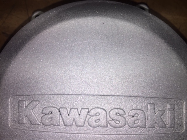

The one engine cover that I messed up with bad paint has been bead blasted. However, I can still see the slight imperfection which did show up in the paint last time round. The machinist says it is a fault in the casting and he reckons I should do a very light coat of filler so it won't show up again.
You can just see the slightly darker 'fissure' running vertical from the 2nd A upwards... ignore the horizontal scratch, that will polish out and/or be covered by the paint. As I have seen the casting problem come through the paint before I am slightly nervous...

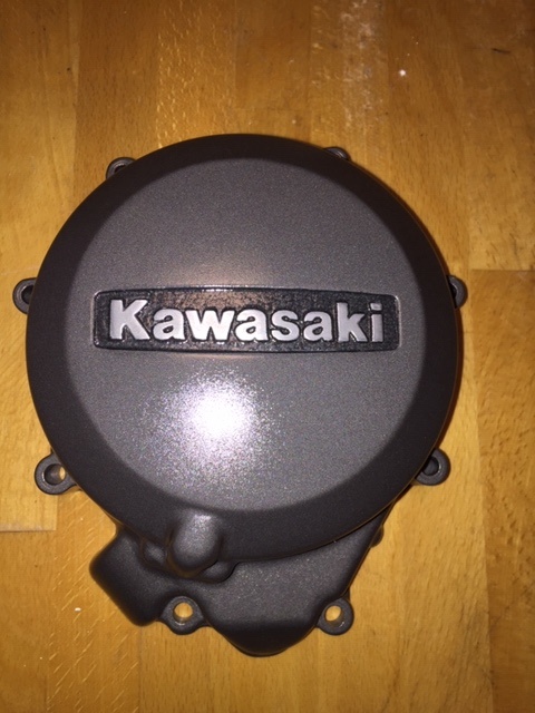

After three failed attempts... victory!!
Now the wait is on the pistons with an extra 10 holes each drilled into them, then assembly of the engine can start again.

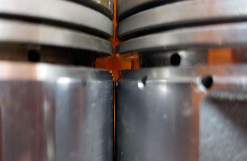

Before your guy will machine the pistons, I just quickly want to show exactly how they look in a close up. I think you mentioned a few posts ago that the bevels are different angles, so I'd like to clarify all the info, as things might be different from a ZN piston.
As I mentioned earlier, there is a machined groove. From my crude measurements with common calipers, it shows 0.55 mm. If you go 0.5 or 0.6 wouldn't make a difference I bet. After doing this to the desired depth, the beveled edge could be touched up slightly to what looks like 45 degrees angle.
There is also a minimal bevel on the top edge above the oil ring. It's not as pronounced as the bottom bevel. Can you see it? I haven't noticed it before, but it's there. Same thing the second ring - but seems to be a little smaller. They both look like 45 degrees. The top ring groove teems to be the same.
You can also get the cues about the measurements from the photo. I don't think it has to be super precise - there is no piston ring going in there.
Hope this helps!
