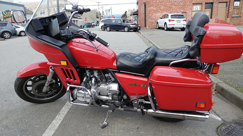

Since you mentioned a Goldwing, here is mine - 1983 GL1100 A. This is the one I'd like to exchange for a Voyager, if a good one shows up at a very good price.
I must say that this bike is a head turner number one. I think its because they were so popular as true cruising bikes of the past, so many people know and remember them. And there are not many on the road these days, and if then not as shiny as this one. So I get lots of complements. Just so you could compare, and I am curious about the prices in Europe as well, converting currency I paid for this one 1800 pounds. Had about 52k km on it.

That is a beauty! The one I am eyeing is a very early one - plain jane, 1000cc, chrome spoke wheels. For quick values, check out UK eBay, or carandclassic...
