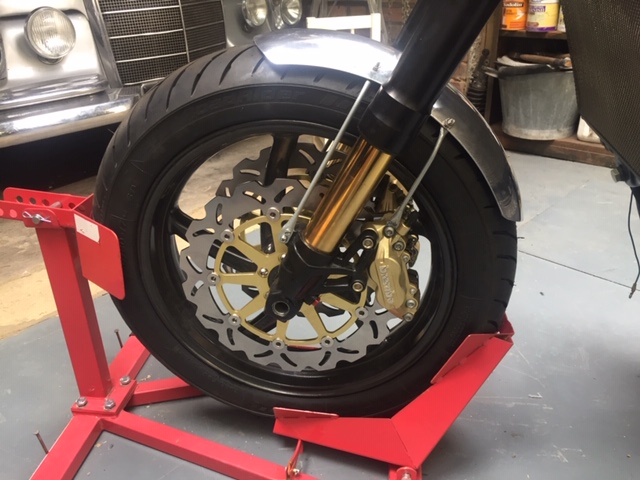

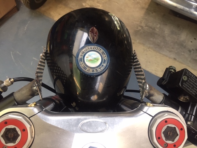

After staring at my abortion of a battery box for a while this morning I decided to leave the electrics alone today and focus on some mechanicals.
Fitted test handlebars (galvanised water pipes) to see how the brake MC, clutch and handles fit (they fit fine) and then put in the (Citroen Traction) headlight and tested where the new speedo could go with a jam jar lid of equal size.
Then I fitted the front spat. Two bars was too unstable so I was going to do four stabiliser bars, but I broke two bits trying to get the RH Brake calliper bolt off before I gave up. It is stable enough and will all be painted black, so methinks no one will notice.
I have taken the bars off to paint and hopefully tomorrow they will go back on, permanently (yeah right, not likely!).

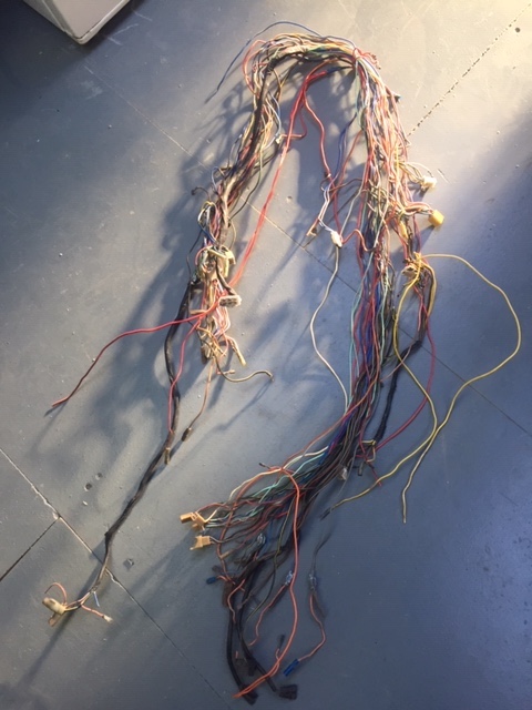

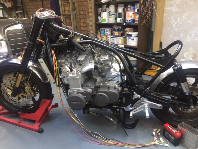

A full day doing... what feels to be nothing, resulting in this mess!!
But a lot better than the old harness... previous owner really went to town on this! :S
Seriously, I made some headway into the wiring, but I am now thinking whether I should route all the wires on the floor through the chassis rather than outside (under the tank and down one rear chassis leg right next to the water overflow tube) with a black sleeve. There is quite a lot of it and if I go through the chassis I will have to drill two fairly significant holes... at least 12/13mm.
BTW... nothing is connected yet, I just lay and cut the wires where they needed to go and labeled them at both ends.
Thoughts welcome!
