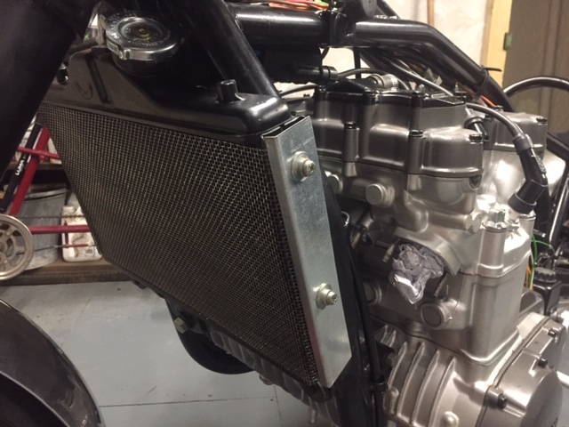

Yes, that was my plan too, until I had the frame done and I decided I did not want to take the engine out again (third time), so I am now building and will be riding it 'bare metal' before I decide to paint the tank and mudguards etc...
It has a certain appeal as well I think, but get riding first, then talk niceties such as colour and graphics...
Some minor progress today. I am finding that I am currently hampered by the postal service... awaiting parts and as soon as they arrive they go on the bike.

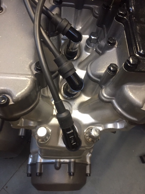

New leads and plug caps

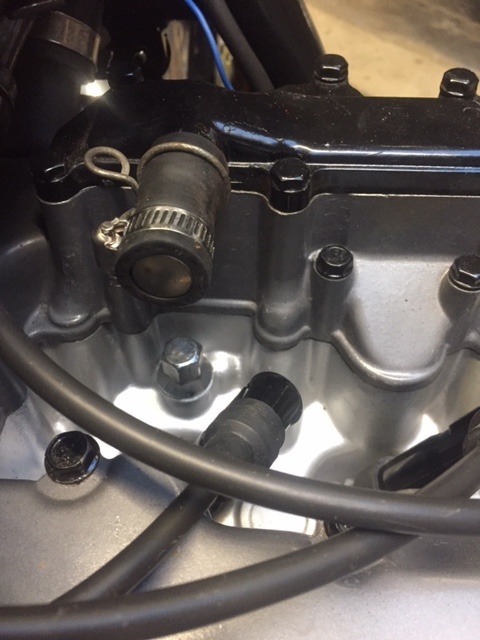

Plugged the top reed vents, ingenious use of an old bearing! But that needs a better, more elegant solution later - maybe making new caps without vent holes...
Radiator on and fully connected.
Top Tip: when inserting the rad, connect the top hose to the rad first, then the bottom hose to the block, then slide the rad in and both hoses over their respective out/inlets.... if you don't connect the top hose to the rad first, you will struggle connecting it as there is VERY little room to work.

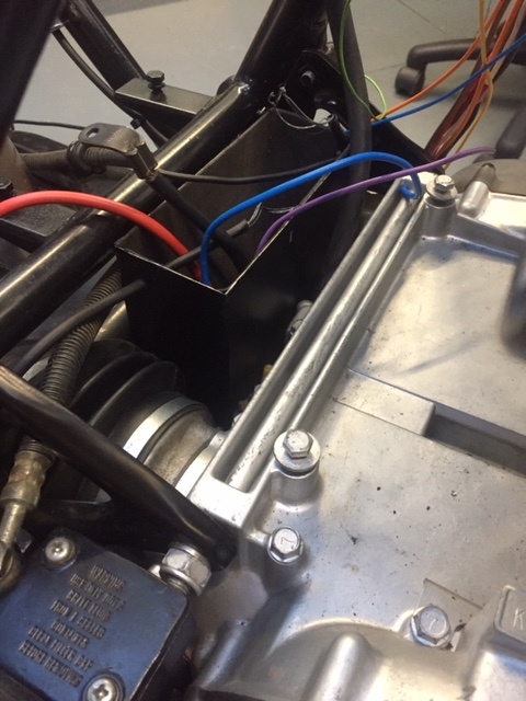

Battery box wired in, awaiting heat shrink sleeve to connect the wires to the M-Unit and battery

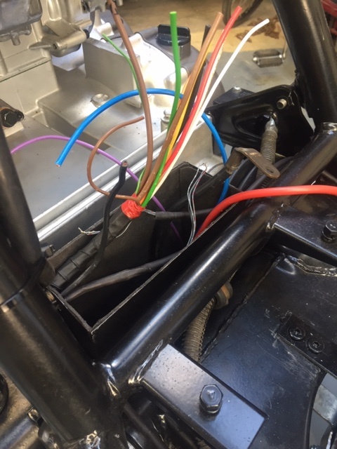

Then finally the headlight wire bundle. Looks worse than it is... really!

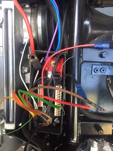

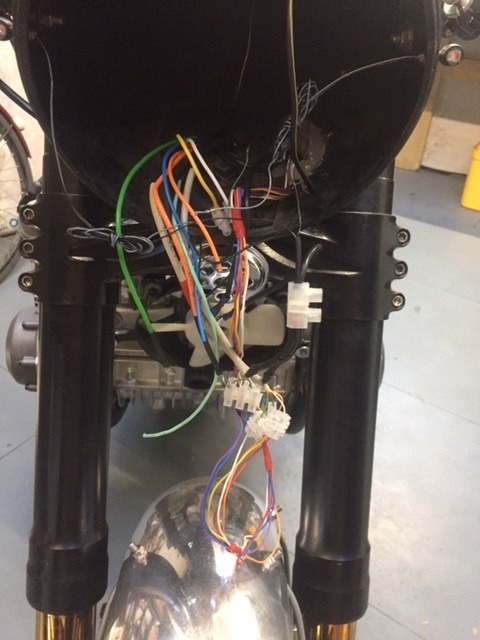

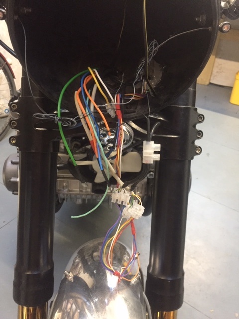

Ugh!
Did I mention I hate wiring? Well, I do, with a vengeance! Here's where I am at the mo... trying to get everything in and buttoned up. Then no doubt take it all apart again to trace some dodgy ground somewhere... anyway... onwards!
This actually looks as bad as it is! :S

That looks manageable. Have you ever seen a telephone engineer working in one of those cabinets on the roadside? You really would have a headache if you had that many wires!
