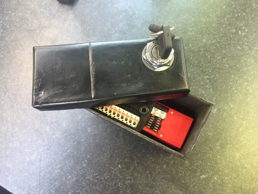

Battery box no3 attempt successful!
I had to turn the welder all the way down to almost zero, and even then had to be very quick with my tacks. But it seems to have worked.
Lid is press fit and will have a security screw on the side, the inside is lined with a think layer of soft rubber/felt, there are two holes at the bottom for starter solenoid and earth cables, and the lid has a thick rubber pad so it keeps everything in place and insulated.
.. Happy!
Now I can start finalising the wiring.
Additional: inserted key lock.
.. Happy!
