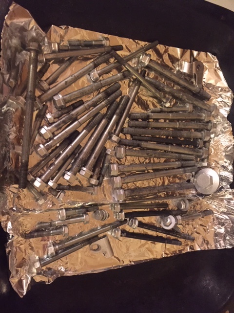

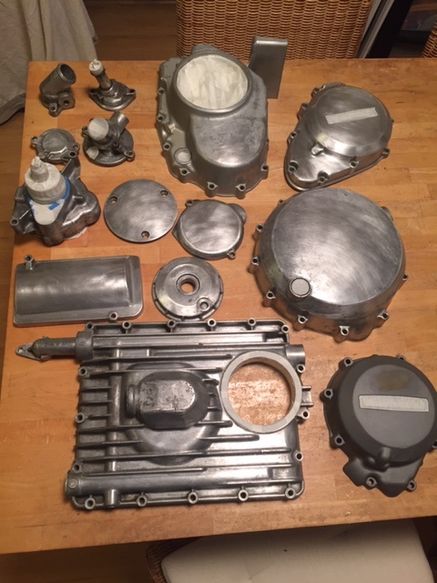

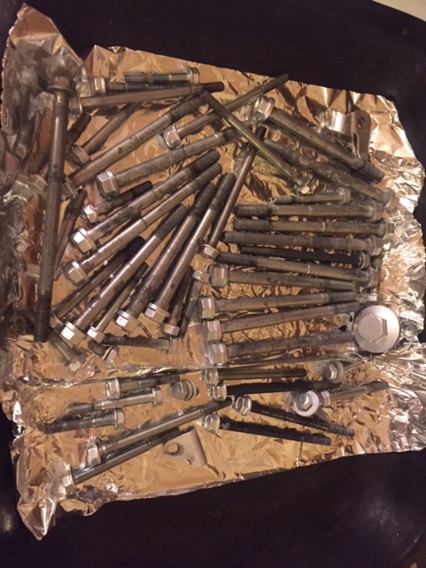

Ok, latest developments:
New shaft coupling boot arrived from Finland and also the water pump mechanical seal from Philippines got here. Cheap eBay finds despite both being brand new.
I have also found a guy who for little money can ultrasonically clean the crankcases and the crankshaft, to clean all the crud out of all the oil ways. Certainly needed as I just took apart the oil pan and flushed those oil ways out with carb cleaner, and LOTS of black cr*p came out. However, the guy pointed out that if I did not take the conrods off the shaft, his cleaning would not get to the oil passages inside the conrods. However, he also said that he COULD get to the shaft oil passages and whatever was left in the rods was not worth taking them apart for (and then having to get new bolts to put them back together again). He also said that these had been apart before as all of the conrods were stamped... confirmation that my engine has been 'at' before. I am picking up the cleaned parts tomorrow. Then degreasing little more and paint-and-bake.
Attached pics of all the bolts with painted-and-baked heads, and all the covers, sanded and masked, ready to be painted-and-baked tomorrow.
Onwards and upwards!
